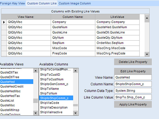

Hoping someone here can help or at least shed some light as to why setting up a Custom Column Like in DataTools works matching a QuoteHed.UD_Field to ShipTo.UD _Field works in Opportunity / Quote Entry but Not in Order Entry matching OrderHed.UD_Field to ShipTo.UD_Field.

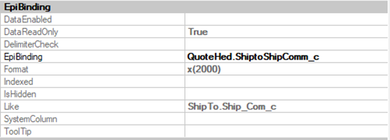

Here is the settings in Quote Entry

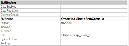

Here is the settings in Order Entry

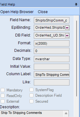

I do the exact same setup in Order Entry only using OrderHed.UD_Field. It seems to add to the Columns with Exisiting Like Values. I can close the data Tools and open it and it will still be there. I can then set the bindings and it will Show the Liked Field. Save the Customization and run it but it does not work, Look at field help and the like field is gone, edit the form and the Like Property is gone in the bindings and in the data tools
