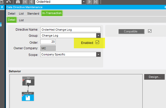

I was reviewing yesterday the logs for the server when someone makes a new sales order, our system is actually pretty slow, so I was trying to know where the problem is, and I found that there´s a Data Directive active, so when one of my users make a new line, it reviews the entire OrderHed table, so, I delete that data directive, but when I create a new log, it still appears to point to the OrderHed table, all of it, even the columns named ´CheckBox1´. Any ideas?
Deleting the Data Directive wont delete existing change logs. And you should have just un-enabled it.
Are you referring to the Change Log, or the Trace log?
Trace Logging has options for what data to trace. “Write Full Data Set”, “Track Changes Only”, etc …
These settings can also be set on the User Account. Make sure they are off there too.
Thanks, I first un-enable it, but it still continue. So i decided to delete it! Then, it´s trace Logging, so I disable all the trace logging options so it doesn´t write anything.
