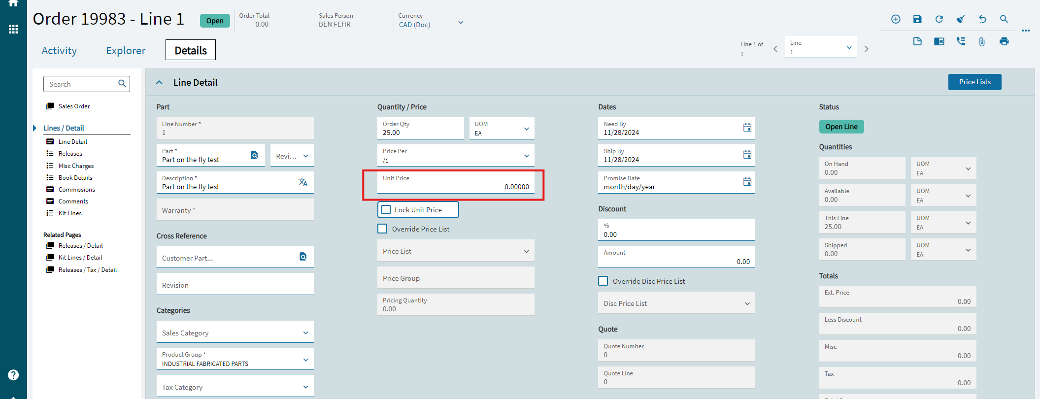

I’m having the issue in sales order entry where my unit price won’t save when its a part on the fly. No issue when this is a part ID. No BPM’s or or layers on any tables.

As in, no matter what you enter in the Unit Price, it is always 0 again when you refresh and/or reload the Order?

He is not getting a unit price.
Its either that fact he is using a part on the fly which is not tided to an active price list due to being a part on the fly or the form is not functioning correctly. We don’t quite know yet
I thought they were saying that they saved a unit price and it went back to 0… I guess we’ll find out!

This isn’t part of a price list since it’s a part on the fly. When I enter a price and click save, it reverts back to zero.
According to epicor, they are already working on a patch for this. I found a work around,
If we enter the unit price first, then enter the order quantity, we are able to save and the unit price will be applied.
