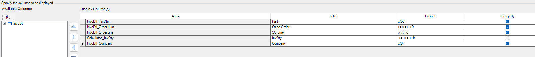

In my BAQ I have a subquery of the invoices that does an aggregate to sum the SellingShipQty and groups on the part number, order number, order line and company. This provides me with the total quantity invoiced regardless of how many times we’ve invoiced against the sales order. I link that subquery to my Top Level on the company, order number and line number and do my calculations to get the balance.

If I were to add the invoice number to my subquery that’s summing the quantities I would have duplicates as well. My subquery would then be summing the quantity shipped per part per invoice number.

The quantity shipped is an aggregate total of the quantities invoiced, it works because in my subquery the invoice number isn’t needed. I link my subquery on the sale order detail in my top level on the order number and order line.
