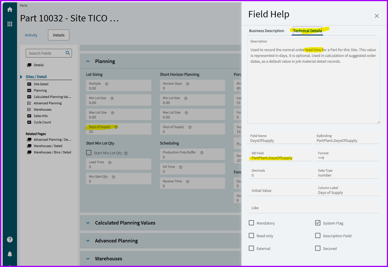

Oh yeah - it’s not your fault! The help is dead wrong.
I reported this in 2019. It’s (incorrectly) copied from lead time.
Good news, though, they accepted this as a bug six years ago! Any day now it should be fixed, right? Right?
I asked support for an update about the field help. They said it’s fixed in 2025.1.
Would anyone be able to check this on a 2025 version? It’s the help on Days of Supply in Part Tracker, for example. (It should not say “lead time.”)
Sorry (not sorry) but I am skeptical, since the PRB has no updates still.

2025.1.11
To be fair, the person did say 2025.1.15+. I should have specified.
So… they could still be right.
2025.2.5
So they c/p the text from the tech details tab into the Biz tab and call it fixed?

So, the description is wrong, is an easy fix, makes Epicor look bad. It leads people astray. (No offense @nmulkey – you actually saw through the lies.) Sure, all true.
