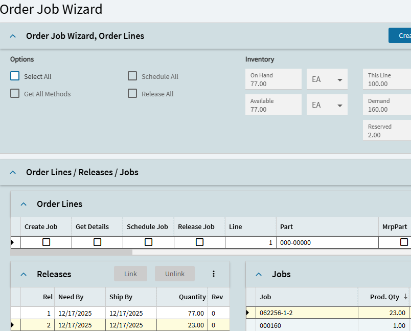

It should work… just verified and it worked for me…
In OJW, are you clicking the LINE checkboxes… or boxes for the specific release?

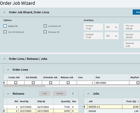

Just to show it created the job fine:
Line Qty: 100
On Hand: 77

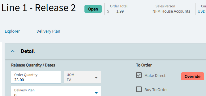

Line 1, Release 1: Qty 77 (from stock)
Line 1, Release 2: Qty 23 (Make Direct)
Resulting Job Created: 62256-1-2 for Qty 23
You know, I’ve never looked at this screen other than the first box. Didn’t realize there was one for releases.
