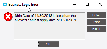

Any error message when she pulls it in manually? Does she have to override the billing date when doing it manually? We saw a similar problem come up just last week where the customer Billing day had been set incorrectly.
Error message that came up was the same as what Aaron is seeing in his Customer Shipment thread.

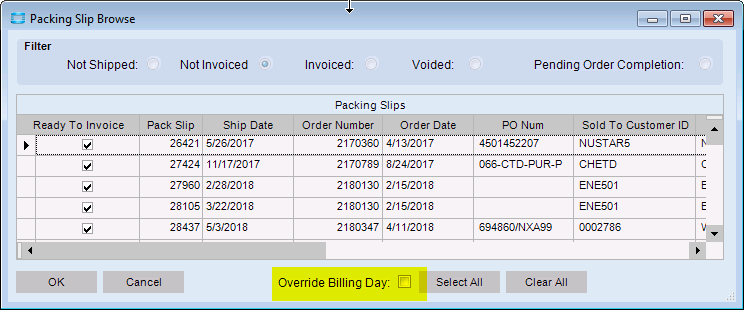

It is not checked (which should be correct). I was looking at that. The only difference that I can find for the customer in question compared to another customer that it works for is that the enable one time ship was unchecked for the problem on. Other than that, all of that stuff seems the same.
We only have one AR person, so she should see all of it. And the bill to is blank on the order. I don’t know if that’s right or not, but seems to be the norm in our system.
Correction, it’s not blank, it’s same as sold to. The bill to on the customer record is blank.
Earliest Apply Date message comes from GL/General Operations/Earliest Apply Date. Check the date to make sure it is set prior to the invoice date. Someone maybe has just discovered this setting and started using it. You can also set earliest apply date by transaction type so check the list view to see if specific transaction types have an earliest apply date

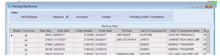

So the shipment does show in the shipped section of that (like below). When she clicks on manual selection, it shows up. She already did a misc for that one, so there isn’t anything else I can do for testing right now.

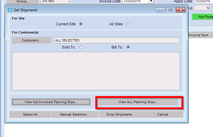

So now the question is, when she clicks on select all, why would something that shows up in the manual selection not come in with select all?
I think it might have something to do with dates like @mjfwagner mentioned, but not the earliest apply dates, since I don’t think we have any of those set up.
So it currently shows as “Ready to Invoice” under “View ALL Packing slips”, but does not show when clicking the “View Not Invoiced Packing slips” button?
