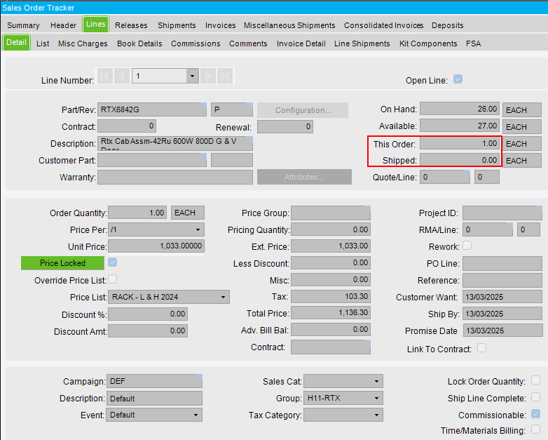

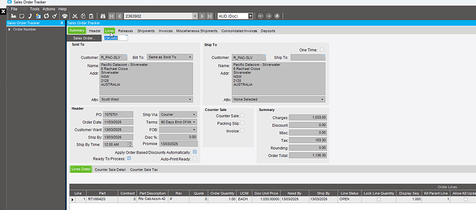

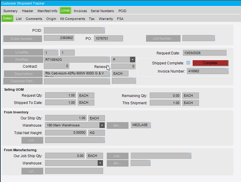

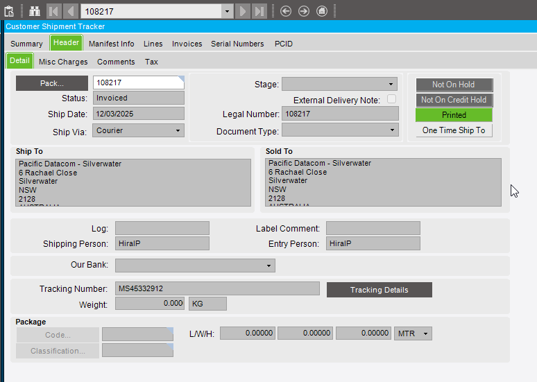

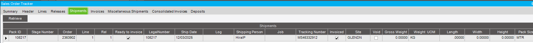

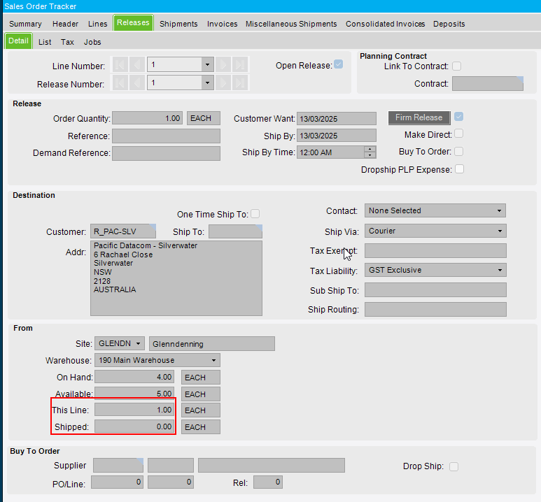

We have been shipping orders normally, but sometimes the shipped orders don’t update the sales order. When you go to the SO, the shipped qty does not get updated but the tracker shows that the line has been shipped and invoiced.
If we manually close the line then it shows that the line was voided.
Any idea how to fix this? This has been happening randomly, can’t identify any pattern. Epicor help can’t solve this for us either.

My understanding is it’s the OurShippedQty fields on the OrdeRel Table that should be being updated to reflect in the tracker.
My thinking is you have some code that is preventing the update of those fields in the OrderRel table.

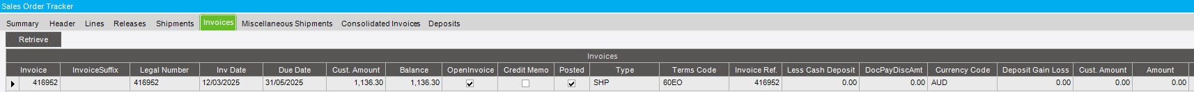

I would be wanting to dig into see if you have any errors in the event or server logs to see if you are experiencing any deadlocks. It may be that it is erroring silently behind the scenes. Are your invoices matching the correct totals on the Sales orders?
