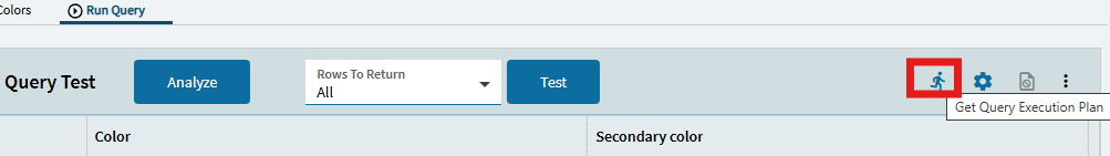

Do you have a quick solution for what to do if that option is grayed out? I see the option in classic but it’s grayed out, and I don’t see anywhere in kinetic that has that option (cloud - working towards go live)
In the browser it is on Run Query panel
is it grayed too?
No that worked perfectly. I was under the impression that stood for “run away!” Thanks again.
I wanted that icon for Run Query, but they made me to use the one that App Studio uses too
I’m with you on this on Olga…
