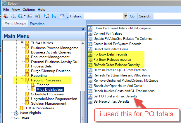

Hi Shelbie,
I had the same problem with our POs after upgrade (wrong totals) and I was instructed to run this Set PO total program, per screenshot. I see some fix book details and releases processes as well as order release quantity stuff. Would these maybe help? Also, have you tried unclicking ready to process, save, reclick ready to process, save?
Nancy
![image](https://epiusers.help/uploads/default/original/2X/2/230bf84aaefdf7322574cda659099b36320513bf.png)

I’m not seeing any of those options on the menu even on the manager log in 😢

I’m having my GM look into this further, could you provide me with what the tree looks like? In this case, where **rebuild processes** is located under?

I don’t have Rebuild Processes (or a few others on the menu screenshot) on 9.05.701. I don’t remember them being in my 9.05.702A test Epicor. I’m guessing that it’s a SQL feature (we’re Progress) or they are in the Epicor 10 menu and aren’t available for E9.

Same here, I have BPM and BAQ within that menu it seems, but not of the others…We have 9.05.700C

The screenshot has the E10 icon, so those are not options for you.
Those fields are calculated for every change you make to the order, so you would have to close the order zero the several order total fields and then re-release all releases and lines. So that is not a feasible option.
Copy Sales order does recalculate them on the new order, so you could copy and then delete the bad order.

I’m sorry it is in E10. I was so excited to get them there when we upgraded. It’s directly under system management.
John, it did fix our PO totals. Post upgrade, i cannot recall, either some or all of the POs didn’t have totals data. We were like wth? I ran the set PO totals and it fixed all of them.
