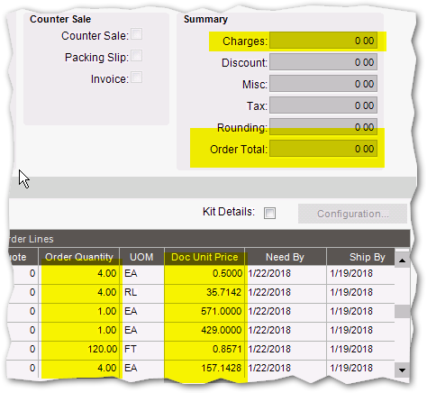

I was making a query to for a report to show the total value of an order, and the total billings against that order, and found many Orders whose Orderhed.OrderAmt is zero, even though the lines have values.
I double checked and there are no discounts or misc charges to offset the lines.
I’m sure this is something simple, but it is eluding me.
From the Summary tab:
![image](https://epiusers.help/uploads/default/original/2X/c/c2108a6ffef393bc9d8773e01a23844966e2f140.png)
From the Lines\Detail tab:
![image](https://epiusers.help/uploads/default/original/2X/5/5593f3af7f68485359ff06097c3816d213bdda10.png)
