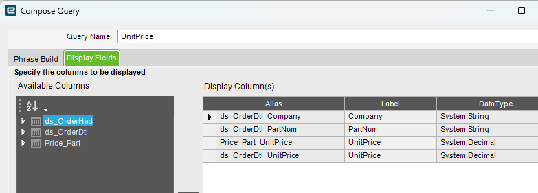

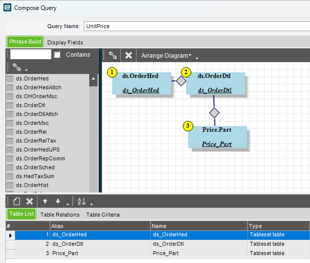

The Fill Table By Query is this:
But I’m not 100% sure I’m doing that piece correctly.
That is inserting data into the Price.Part table.

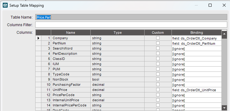

Here is the mapping:
Invoke BO Method uses “Erp.Part.UpdateExt” BO method
Here is the binding I’ve setup:
The idea is if The Price is going to be fetched from the Part Master, then I want to save the Sales Order Line UnitPrice to the Part Master UnitPrice before the Erp.BO.SalesOrder.ChangeOrderHedCustomerCustID is triggered.
