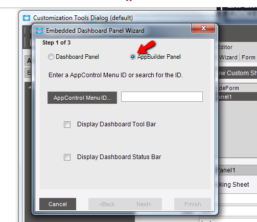

See if you can use this option:
2018-05-10_0838
I just did before you replied lol. Seems to be what I need, however for some reason it loads the base version of my menu, not the customized one. When I open the menu on its own, it works perfectly. Is this a limitation of embedded menu dashboards?

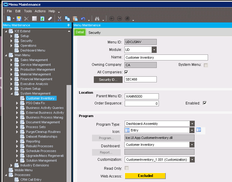

if you do an appbuilder, it is associated with the menu ID (Including the customization that you have associated in the menu).
Did you try it on your end also, just for confirming? A colleague of mine tried on his end and it loads the base menu for him also.
Can you send a screenshot from within your Menu Maintenance - of that particular Menu
