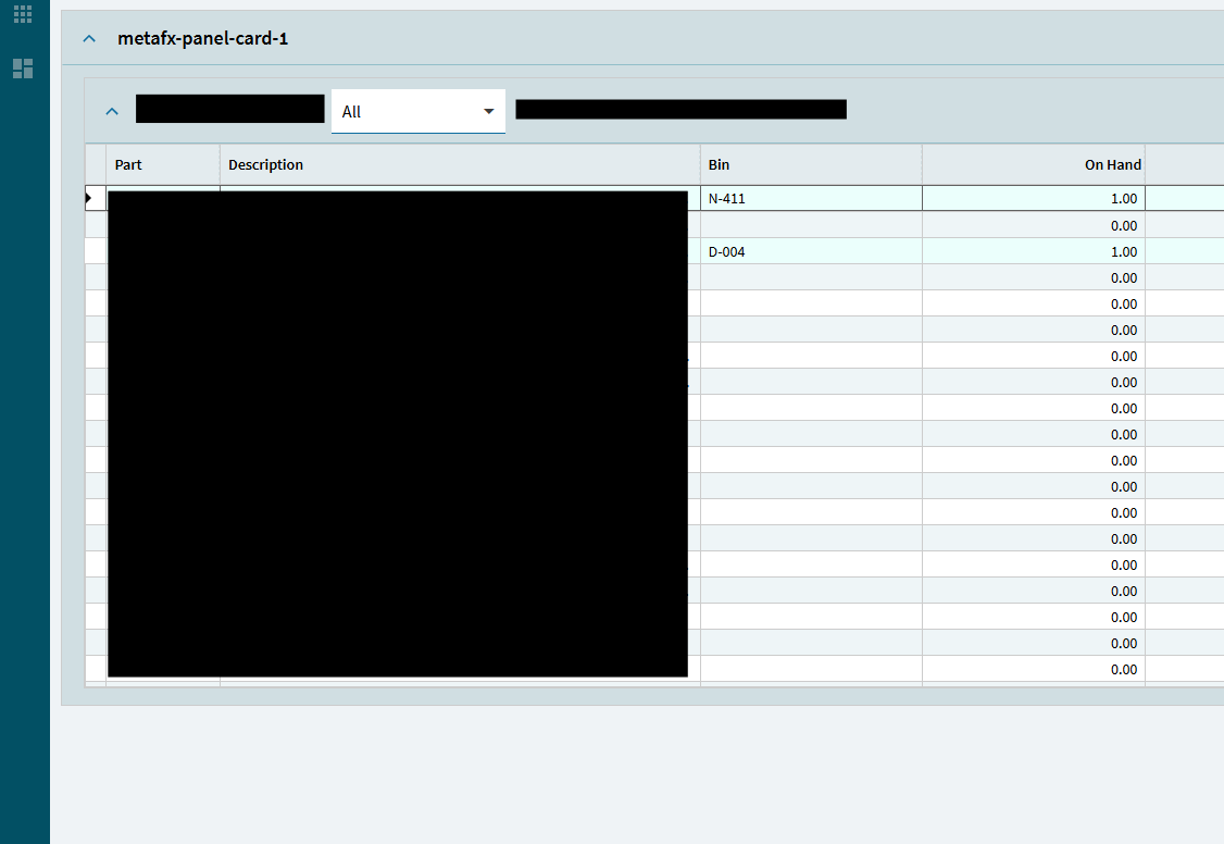

Except one grid, it’s huge in height, many many time taller than the content.

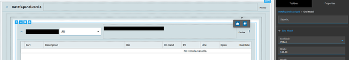

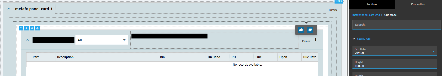

One thing you could try and test, which MAY help control the size, is to put the panel card grid(s) inside another panel card.
Then, again, try to set the height in the Grid Model:
Set @ 100

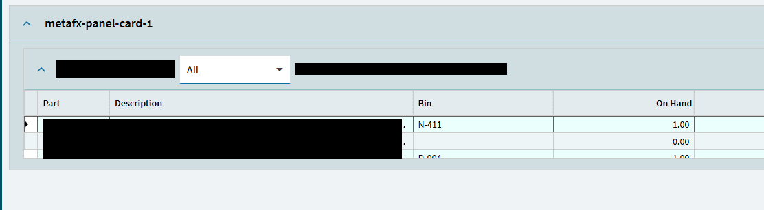

Preview:

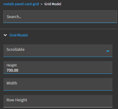

Set @ 500
That’s very strange behaviour. In my experience, by default grids will display about 9 rows and I use Grid Model > Height to adjust. Are you changing the Min Width setting by any chance? If you can’t find a setting or combination of settings that’s causing it, I would rebuild from scratch, adding one grid at a time.
