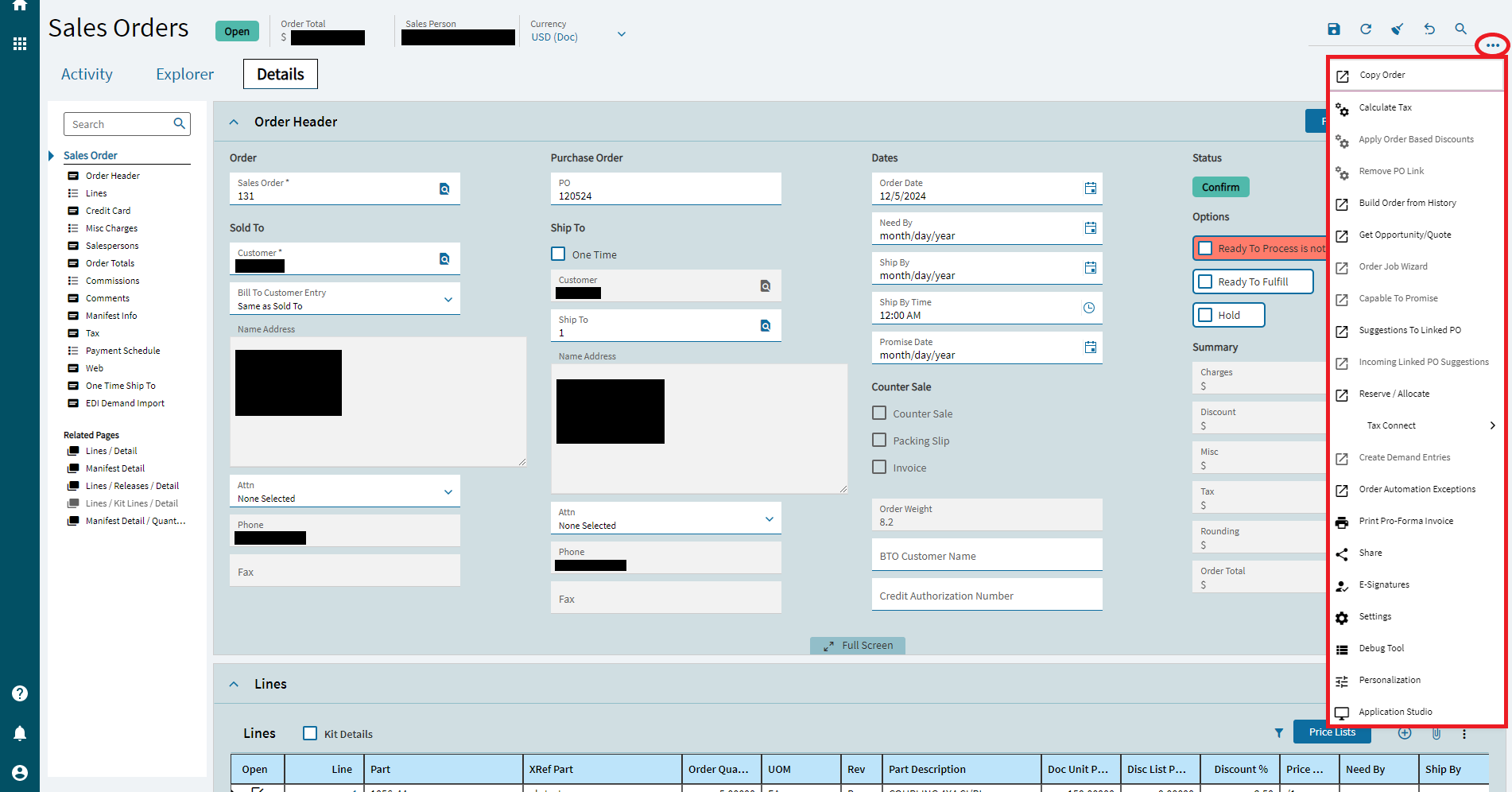

Working on a custom layer, and somehow I removed the delete order option from the overflow menu, but I don’t know what I did, or how to get it back.
I believe this occured in the custom layer, because I can remove the layer from the menu item and the delete option returns.

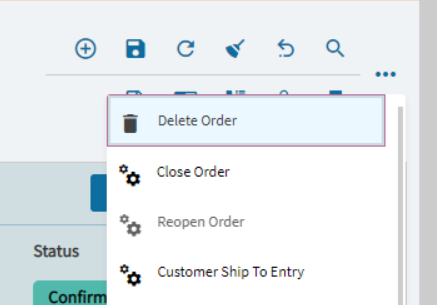

this is the option that has disappeared
There have been several reports of these issues lately. Mostly people talking about their missing New (+) Icon… which, if you look at your image, that’s missing also:

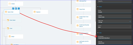

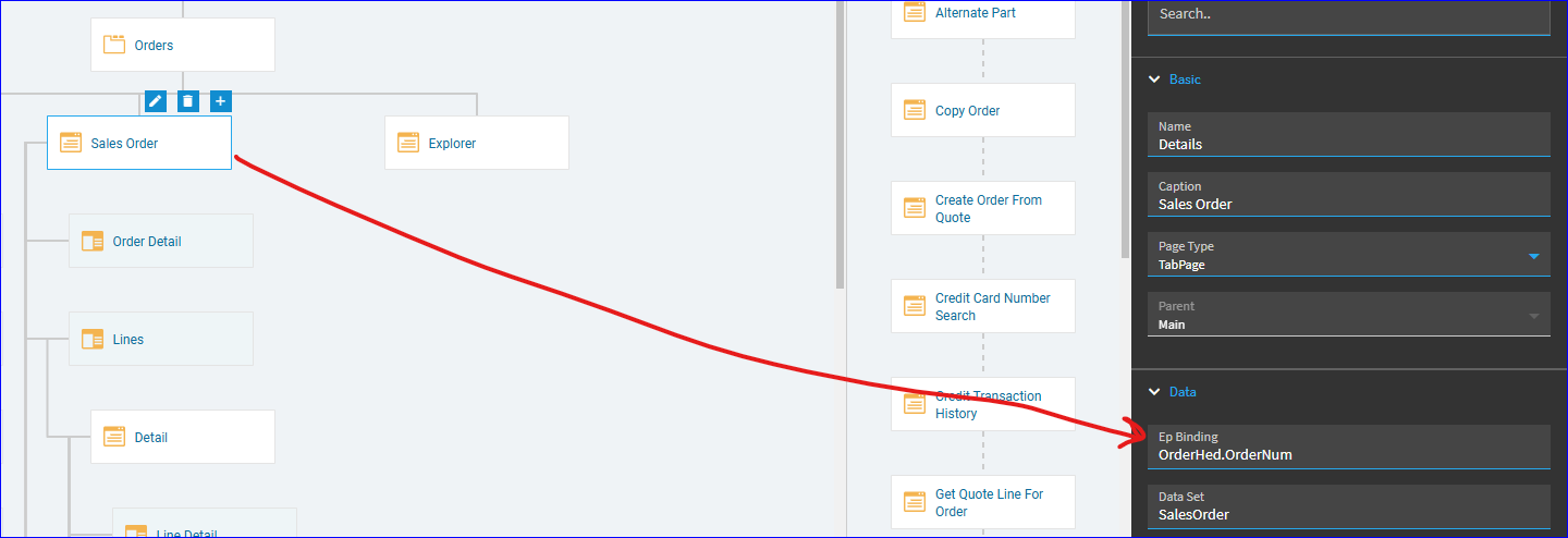

One thing I’ve seen is to verify your Sales Order page isn’t missing its epbinding.
That was it. The details card somehow lost it.

Found my binding was also missing, added it back in, worked like a charm.

Just realized my Close Line option was also missing. The culprit?
Missing Ep Binding on the Order Details page!
Found the issue in minutes rather than hours thanks to all of you! :clap::clap::clap:

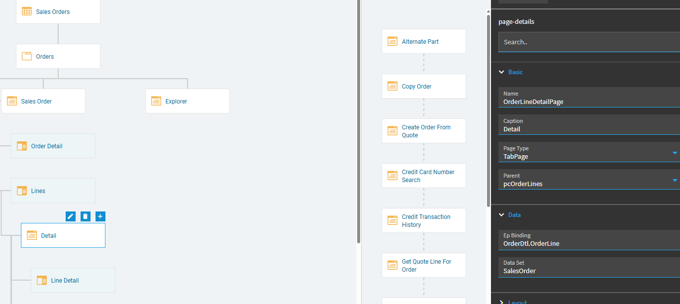

thanks for your reply David, the sales order page has the required EpiBinding but the Lines Details is blank, i do not know what to link it to nor if it is required to put any, my issue that Close/Re-Open Lines function have disappeared completely from Kinetic overflow menu
Here’s a screen shot of my Lines-Detail page settings… can give it a shot.
You can always look at the BASE layer to get standard settings if you need to verify.
great David, this fixed the issue, many thanks mate, really appreciate your help Sir.
