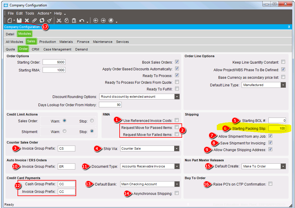

I found it, in case someone else would need this.
Open Company Configuration then Modules->Sales->Order
Under Shipping it should be “Starting Packing Slip”
The reason I could not find it was because I kept looking under Modules->Materials->ShippingReceiving tab.
