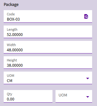

  1. Can someone explain to me how the Pack Out works? I’ll explain my understanding, but I’m not entirely sure it’s correct: I created a shipment with three lines, but I need to add a box with unique dimensions to each line. To do this, I went to Pack Out and generated a Pack ID for each line, then grouped those three Pack IDs using the Master Pack Shipment Entry option.
  2. Where can I see the package dimensions (report)?
