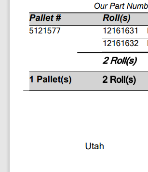

Ok I got something that might work, but I don’t know what this field is actually for, so caveat emptor .
The report parameters have a field called DocCopyNum that is passed down to the report.
This is what the report sees:

You can modify the rdl to pull it in the RptParameter dataset.
="SELECT T1.DecimalsQuantity, T1.DocCopyNum FROM RptParameter_" + Parameters!TableGuid.Value + " T1"

Yeah that could work then, I’ll check Haso’s chm to see if it has anything on what that field is for, but yeah that’s what I was hoping to do, hijack a field.

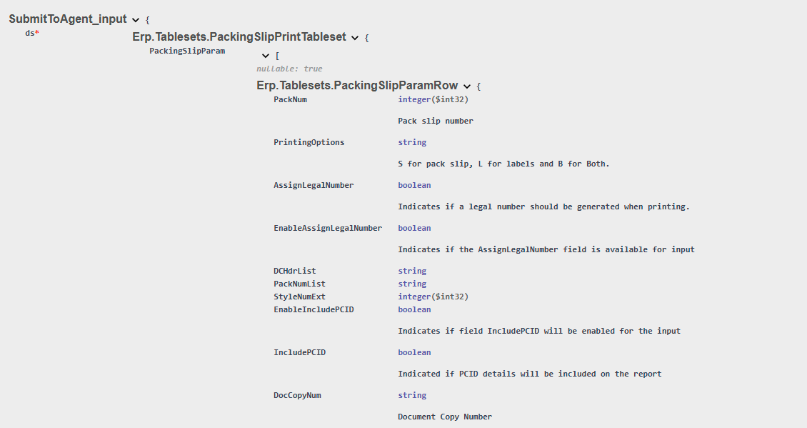

Should be, was available in the bpm for SubmitToAgent.
klincecum
(Kevin Lincecum)
November 12, 2024, 7:10pm
13
Pic reuploaded, wrong service the first time.
