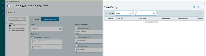

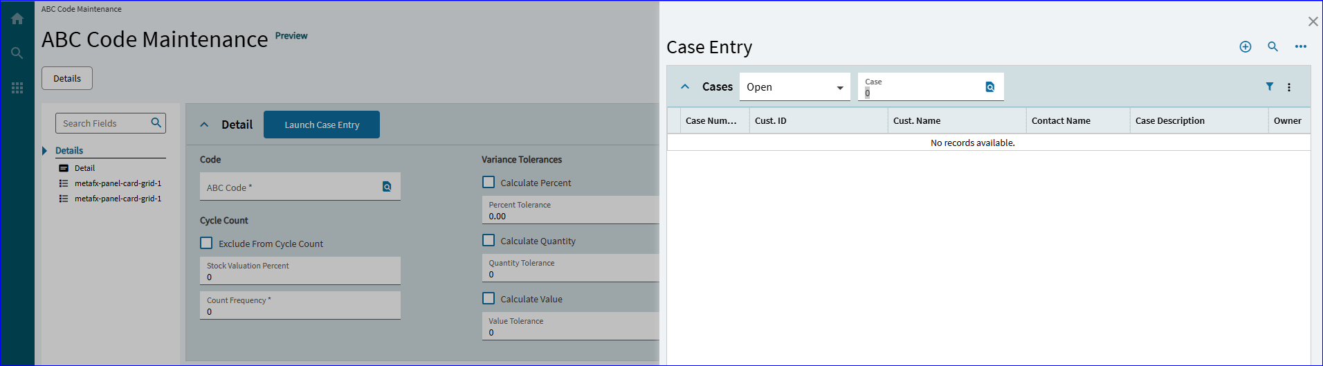

In Kinetic, the easiest way to do this type of thing is with a button that triggers a slider panel which opens Case Entry.
Example… I add a button that says “Launch Case Entry”… when clicked, Case Entry slides out from the side.
Or you could have Case Entry open in a new browser tab/window if that is more preferrable.

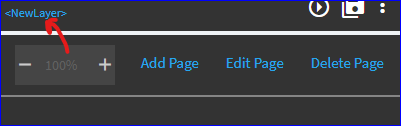

In App Studio, Click the < NewLayer > link

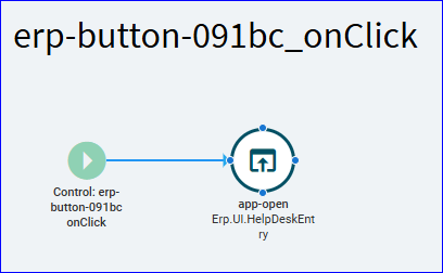

Wire up an On-Click event to call an app-open:
In the button properties, expand the Behavior settings and click on “On Click”
This will create an on-click event for you named: whateveryourbuttonIDwas_onClick
Below is what it looks like when you don’t give is a better buttonID, haha.

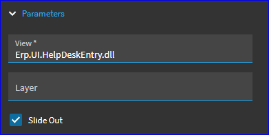

Your trigger should be pre-set. You need to go into the toolbox and drag in an app-open widget.

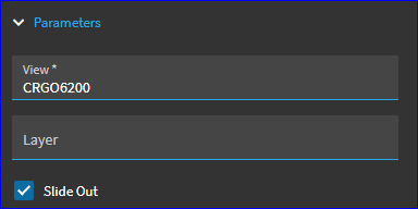

Click on the app-open widget you dropped in and open its properties… click on Parameters.
Below is an example.
For the “View”… you can either put in the “long form” and type out the application… (works with or without the .dll extension).
OR… you can type in the menu ID:
Just beware that the specific menuID… is specific, so in this case it is the Case Entry menu found in Customer Relationship Management. But if a user doesn’t have access to that, it may not work. They may have access to Case Entry via Case Management and that is menu HDMN2100… so, it is often “safer” to use the program name vs the menuID… but both work.
The “Layer” setting is if you already have a customized layer(s) on that target program you’re opening (Case Entry in this case). If so, you type that layer name(s) in here (if you want it/them applied). If you don’t, it will open the BASE Case Entry with no custom layers applied.
Make your choice on whether you want this to open via “Slide Out” panel or not. If that is checked, it will be a slide out, if not, it will open a new browser tab for the opened page.
… and that’s pretty much it.
Save your layer and hit the preview button to test it. Click your new button and see if it opens Case Entry.
