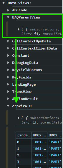

Note that even though I have a “BAQParentView”… it is empty. Instead, I didn’t tell Epicor where to store it, so it created its own temp dataview and stored the results from the BAQ call:
You need to EITHER, use an event to call your BAQ and steer the results TO your dataview… OR (much easier if you’re using provider model)… you HAVE to set this property on your parent’s Grid Model > Provider Model:

If you’re not using “events” to populate your dataviews, the Provider Model will do it for you… IF you set that property and tell the data what dataview to land in.
If not it lands in a temp dataview. For example, I didn’t define that property for my Child grid… and the results got pushed here:
Another fun fact… I didn’t even CREATE the BAQParentView dataview:
But if it put that name in that Provider Model property, the application adds the dataview on the fly.

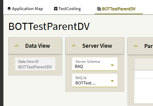

@Randy, I’m not entirely sure what you’d like me to show. Could you be more specific on what data you’d like to see?
Do you have this setting defined in your Parent grid’s Provider Model? Its the very first setting. This should be the name of your Parent Dataview.
Trying to follow everything you posted above as you guys are miles ahead of me on this stuff.
But, to answer your last question. This is what is set in the parent grid:
That is my parent dataview:

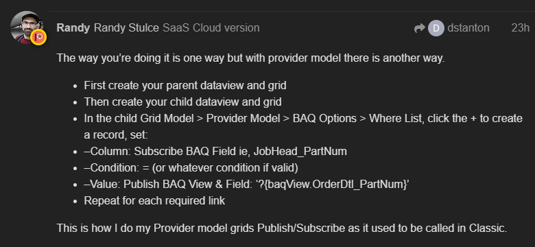

I used to use the Where List in Provider Model but then I discovered the Parent Child relationships and this is a much better/simpler way IMO. See my notes below.

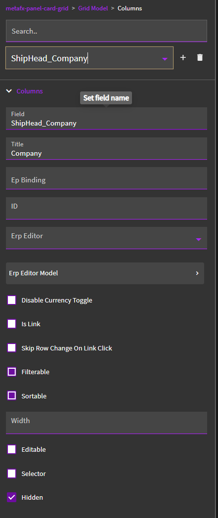

The parent grid has to have the columns exposed to the child dataview. Regardless if you have set the parent child relationship up in the child dataview, if the columns don’t exist in the parent (hidden or not), which can happen if you misguidedly thought that unchecking visible in the Grid Guided setup, meant setting the Hidden property.

The fix manually add the column in my instance I was missing company. I added it manually and made it hidden. It then appeared in the currentParentDataRow list.
Moral of the story when using the Grid Guided Setup Wizard… Don’t uncheck the visible columns. Go back later to hide where appropriate. I was under the assumption if you just untick visible then it would add the column as Hidden which is not the case.
