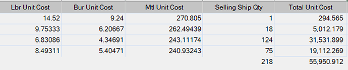

The Produced it tab just takes the numbers you see in Job Tracker and divides them by the production quantity of the job to get an average cost per unit.
The profitable tab takes each invoice and takes the cost of that shipment or receipt to finished goods and costs it with the costs of the job per unit at the time of shipment or issue to finished goods.
They both equal the total, but one is the average and the other is an event(s)(shipment/receipt) with a quantity. Below is from one job with 4 shipments
From Profitable Tab
