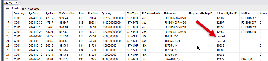

We have a Warehouse Team called ‘Expedition’. All allocated sales orders are picked by this team. During allocation the user gets a pop-up presented ‘Do you want to print?’. If you click ‘Yes’ there will be no Material Queue record for team Expedition.
My sort of logic explanation to the order managers is that you tell the system it will be picked from a paper in stead of a digital pick list (Material Queue) and if Epicor would also create a Material Queue record there is a chance you pick items twice. :slight_smile:
I did know that, but you’re right, it is a helpful tip to know!
Actually, it’s still there, it’s just assigned to “Printed”. If you process by seq (using the barcode on the paper) you can still use them.
Yes that’s true. Just for the proces, people expects it to appear in ‘My Selections’ and having it assigned to employee ‘Printed’ it’s nowhere to be found by a shopfloor employee. For us off course it’s eventually an easy find.
