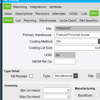

From where does the part BackFlush flag set automatically?
We do not use backflush, but we still found parts flagged.
if it is flagged on the job, then the Part master > Site > detail…bottom right

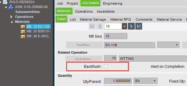

where did it’s flagged on the job?
Material tab
Query: PartPlant.backflush = true
then you would have to query JobMtl.BackFlush = true
