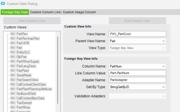

I’m looking to create a FKV to display the standard cost either on the part master or po detail.
I kind of remember how to setup a FKV, but memory is failing me and the YT videos I have found aren’t getting it done.
I’m missing a step somewhere as I don’t recall where to link the foreign table.

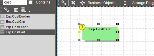

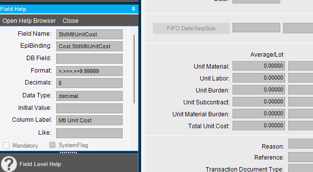

To make it more interesting, I don’t know what table name to pull the cost from as there is a naming discrepancy, cost. in the cost adjustment module and costpart in BAQ design.
I’ll take any advice, up to and including a career change. :slight_smile:
Thank you!
PartCost is where the “current standard cost” is stored. CostPart is where your cost sets from Costing Workbench are stored.
Cost - as shown in your second image - is the name of the dataview in that form.

I always found it frustrating how many different ways you could go about doing the same thing… usually unclear to what makes the most sense. A BAQ Dataview might be a good fit for this if you’re just looking up standard cost to display it. There should be examples on here for that. I’m not sure if you’ll find the adapter you’re looking for in the FKV to pull in the cost record associated to that part. But if it’s there, you’re halfway there.
I’m not familiar with that, FKV were my only tool, and it’s a dull one at that. I’ll do a little more digging to see if I can find some guides on baq dataviews.

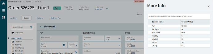

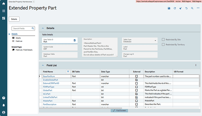

Sorry, they are a powerful tool to pull info and we have a few. They aren’t hard to setup:
  • Step one is make a BAQ to display what you want so probably PartNum and Standard Cost fields.

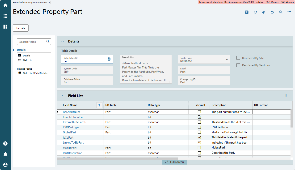

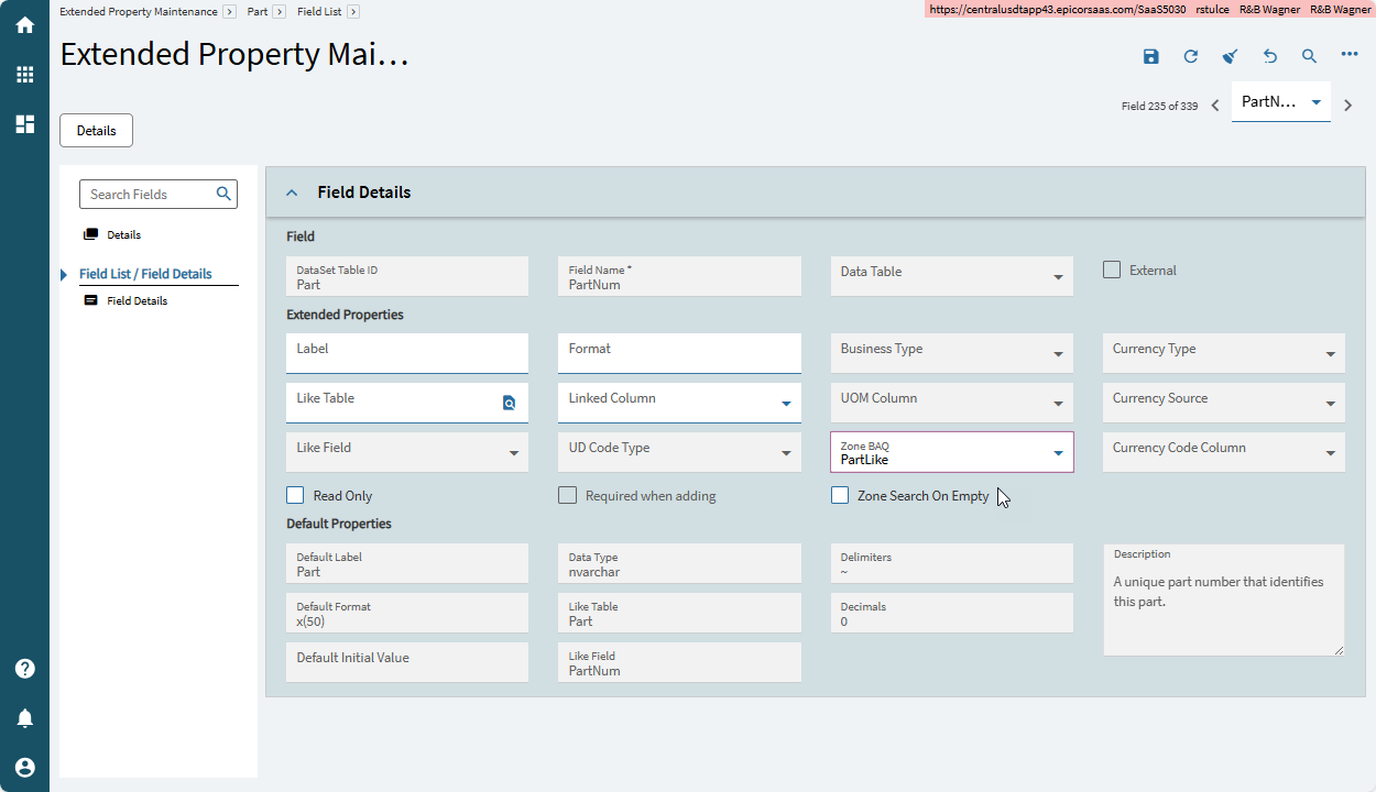

  • Step two in Extended properties, DataTable ID = “Part”
    Then find Field Name = “PartNum” and set the Zone BAQ to the BAQ ID from step 1
  • Repeat step two for PO Detail’s partnum field.

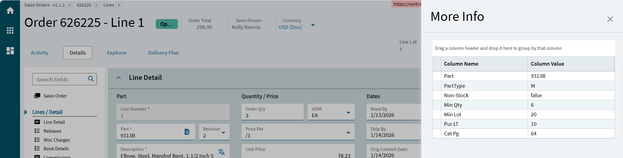

Then in Part Entry and open a part and right-click on the Part# and select “More Info” from the list. It’ll run your BAQ and show the data. Here is an example of one we have in Order Entry for Part# info:
