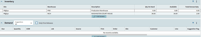

We have a part that Part Tracker shows a demand of 2 pcs. However, looking in Job Manager (screen shot attached) doesn’t show any demand. I ran the Refresh Part Quantities and Allocations report in Pilot but that part didn’t show up on the report. ???
How do I see what is driving the demand???

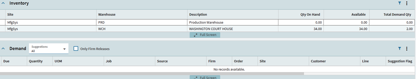

Checking Time Phase is a good place to start.
Nothing shows here either. :frowning:
