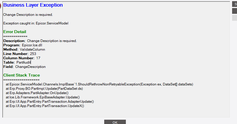

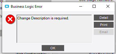

So far, I’ve been able to create (buggy) records on the Audit Log that don’t actually seem to save, and I’m struggling to get all required fields to populate. I’m getting an error that required fields are missing (after the new record is viewable in the Audit Log).

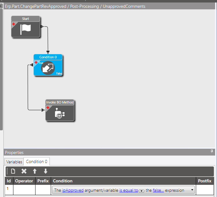

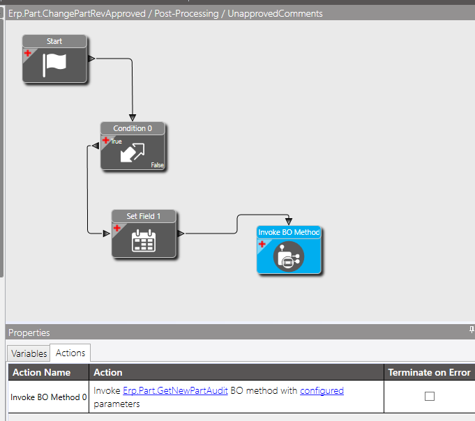

My not-really-working solution so far consists of a Pre and Post Method directive on the Erp.Part.ChangePartRevApproved method. I ran a Trace when unchecking approved on the revision in part maintenance to get these. At this point, I’m not trying to replicate the text box. Just trying to get a valid row on the PartAudit Log first, then plan on using a BPM data form.

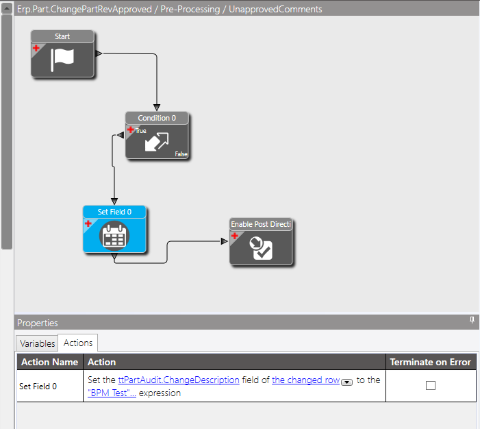

Pre: Checks if the approved field is false, then sets the description field that I think the error refers to and enables the post directive.

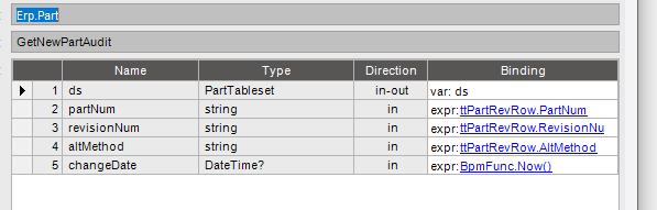

Post: Enabled from Pre directive, tried changing that same description field here as well, then invokes BO Method Part.GetNewPartAudit with the same ds.
Full error:
A few times, I did see “BPM test” (my message i set in the BPMs) in the change description textbox, but was still getting an error. Anything glaringly wrong with my approach here? Any help/suggestions are much appreciated!

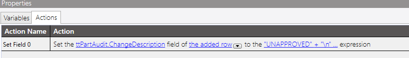

Checked some more boxes on the trace log, and realized none of my field changes were doing anything as the Part.Update still had empty parameters. Probably because the GetNewPartAudit method hadn’t actually added a new row yet when I was previously updating the field. Ended up getting it working by adding the condition/field update to the Part.Update BO/method.

I would like to automatically fill a change description for the GetNewPartAudit. Do I add the description within the method (I don’t see an applicable field for that), or do I use an update table by query widget?

Here’s how I did it in the Part.Update method. It’s somewhere in the dataset generated from GetNewPartAudit so you could do “update table by query” or “Set field” (if the table/dataset isn’t completely empty).
