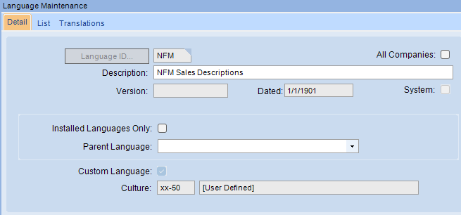

Then was created a custom language in Language Maintenance:

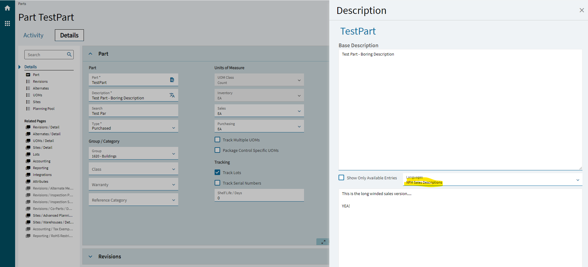

Then… on the Part Record, you can enter BOTH:
Next… set your Customer’s Language to your “Sales Description” language… and that is the description that will appear on your quote.
So, internally, our forms use the “Engineering Description”. But Customer facing documents use the “Sales Description”
