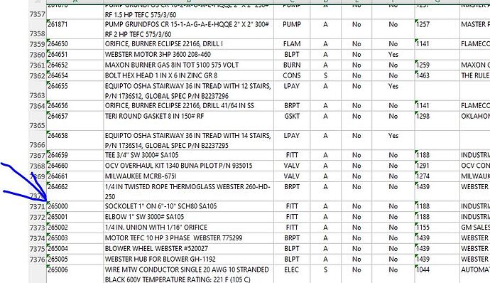

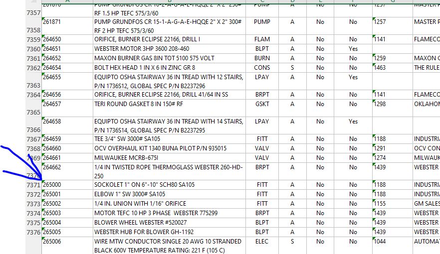

Hello, I have a question about creating a BAQ to display part numbers that have NOT been generated yet. As you can see in the picture below, we have a lot of part numbers that have gaps between them (such as between part 264662-265000). Instead of adding onto the list, we would like to start filling those gaps when we do add new parts.
Is there a way to create a BAQ to display those gaps or “available” spaces between existing part numbers? I haven’t had much luck and maybe there’s an easier way to generate that list than a BAQ. Any advice is greatly appreciated.
Thank you

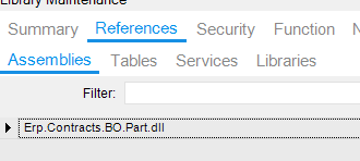

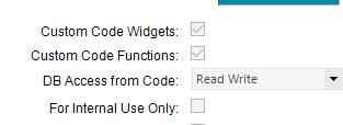

Also make sure that our function library has the proper access:

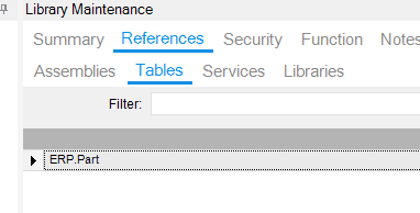

and if querying:

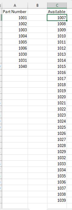

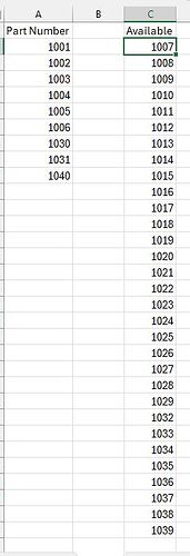

I tapped AI to solve this one in Excel. First export your list of part numbers (assuming they are integers). Paste them in Excel columnA. In column C put in this formula:
=IFERROR(SMALL(IF(ISNA(MATCH(ROW(INDIRECT(MIN(A:A)&":"&MAX(A:A))), A:A, 0)), ROW(INDIRECT(MIN(A:A)&":"&MAX(A:A))), ""), ROW()-1), "")
Then copy it down column C until you see all the values between the upper and lower limits found in column A. It reports only the unused numbers in the range.

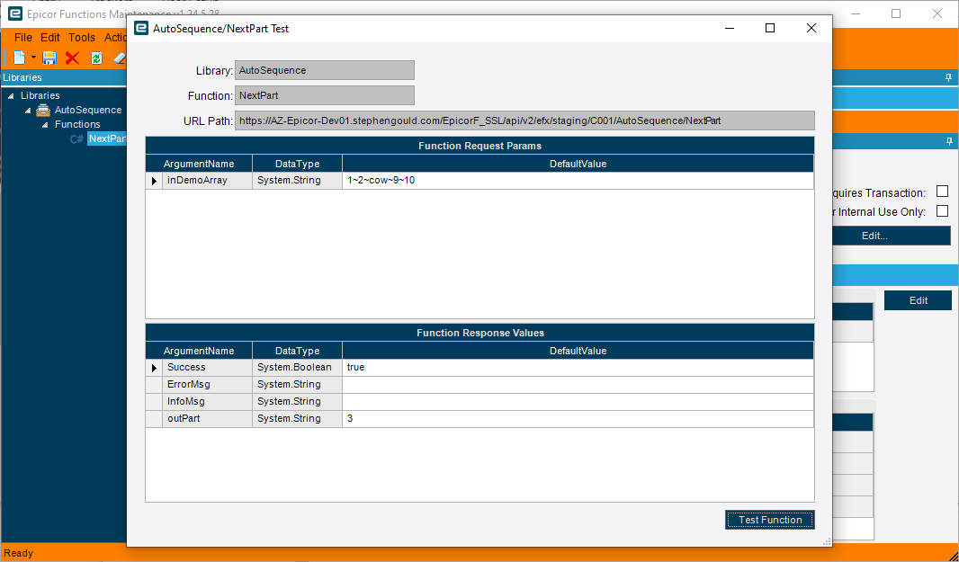

AutoSequence.efxb (2.8 KB)
No Excel needed. Make Epicor do the work.
You could also just paste this code into an Execute Code widget in the BPM instead of calling the function.
Function Code
try
  // Get a list of part numbers in the system
  var partNumList = (
    from p in Db.Part
    where p.Company == Session.CompanyID
    select p.PartNum).ToArray();
  // Was used for testing
  // var partNumList = inDemoArray.Split('~').ToArray();
  if( partNumList.Count() > 0 )
    for( int i = 0; i < partNumList.Count(); i++ )
      int curPart = 0; // Change this to be your desired starting value - 1
      int nextPart = 0; // Change this to be your desired starting value - 1
      Int32.TryParse(partNumList[i], out curPart);
      // If i + 1 is valid, then parse, else return junk
      if( i + 1 < partNumList.Count() )
        Int32.TryParse(partNumList[i + 1], out nextPart);
      else
        nextPart = -1;
      // Check to see if nextPart is sequential, if not, return next sequential part
      if( (curPart + 1) != nextPart )
        outPart = (curPart + 1).ToString();
        Success = true;
        return;
catch(Exception e)
  Success = false;
  ErrorMsg = e.Message.ToString();

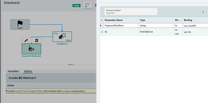

This will definitely get the job done. I did notice that the BPM version here might cause you an issue by setting the PartNum as part of GetNewPart. You lose some of the default settings (Units of Measure, for example) by doing that instead of calling ChangePartNum. You can avoid that with a few tweaks, though.
If you put the code in a Conditional widget and then Invoke the Part.ChangePartNum BO Method, it will pull the Part defaults and still set the partnum you’re looking for.
