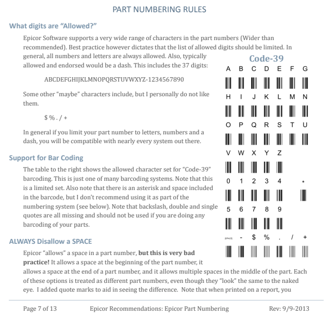

Just don’t use spaces… also consider that Code-39 is a standard bar code set that has limited values. Here is a portion from a white paper I wrote many years ago.

There a few discussion on here regarding P/N schemes. The majority opinion, is to avoid intelligent P/N’s (ones where the segments mean specific things, like: HW-PHSC-0440-1.000

Here it is - written years ago, but I still hold by these standards :Epicor Part Numbering Standards.pdf (799.2 KB)
