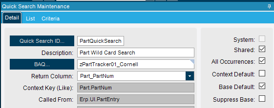

Here’s the settings of that Quick Search:
Did you try checking the option ā€˜Suppress Base’ ?
I haven’t, because I don’t want it to suppress the base. There are certain places (New PO Suggestions, for example) where we have to use the base search rather than our generic quick search in order to get the correct results.
I suppose I’ll give that a go in Pilot just for troubleshooting purposes and something more to go back to Epicor about if it’s still showing the base search by default.
When you select ā€œsuppress baseā€, you get an option button on the search itself for ā€œbase searchā€ā€¦ so it becomes a question of which way will annoy fewer people?
Oh, interesting. It’s been my understanding that ā€œSuppress Baseā€ meant that it hid that ā€œBase Searchā€ button from the users. Definitely going to play around with it now.
Suppress Base does hide the Base Search button and it doesn’t default the Part search in BOM Listing Report to the quick search rather than the Base search. Interestingly, if you have a Named Search (in Classic) set up off the base search and saved as the default search in a particular screen, that saved base search appears rather than the quick search even with the base suppressed.
