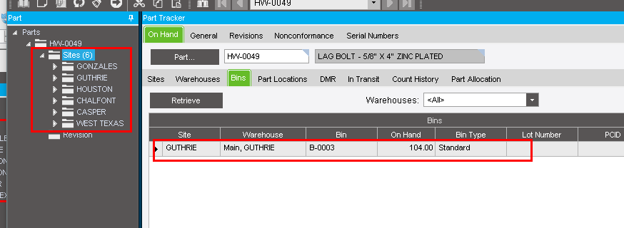

For example, Part HW-0049 is enabled in 6 plants, but only one has any QOH:

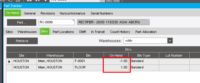

And this part Appears to be in site HOUSTON, but actually has a zero QOH
