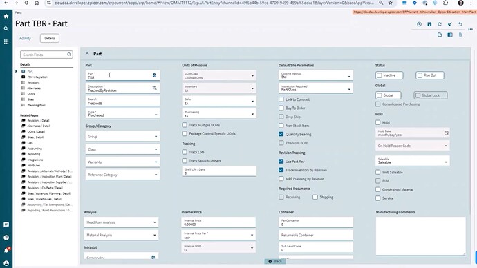

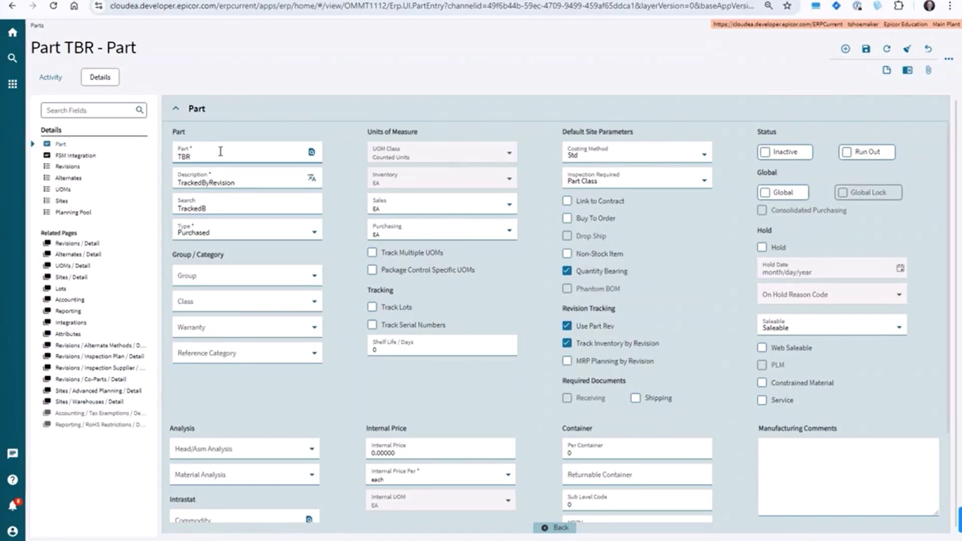

Not using Track Inventory by Revision makes this true. Here is a video of a Part that has Track Inventory by Revision as true and has multiple revs. You can see in the tree that when rev 0 is selected (which does not have a method) the details disappear.
Edit: This recording is from Engineering Workbench

Screenshot from @timshuwy presentation:

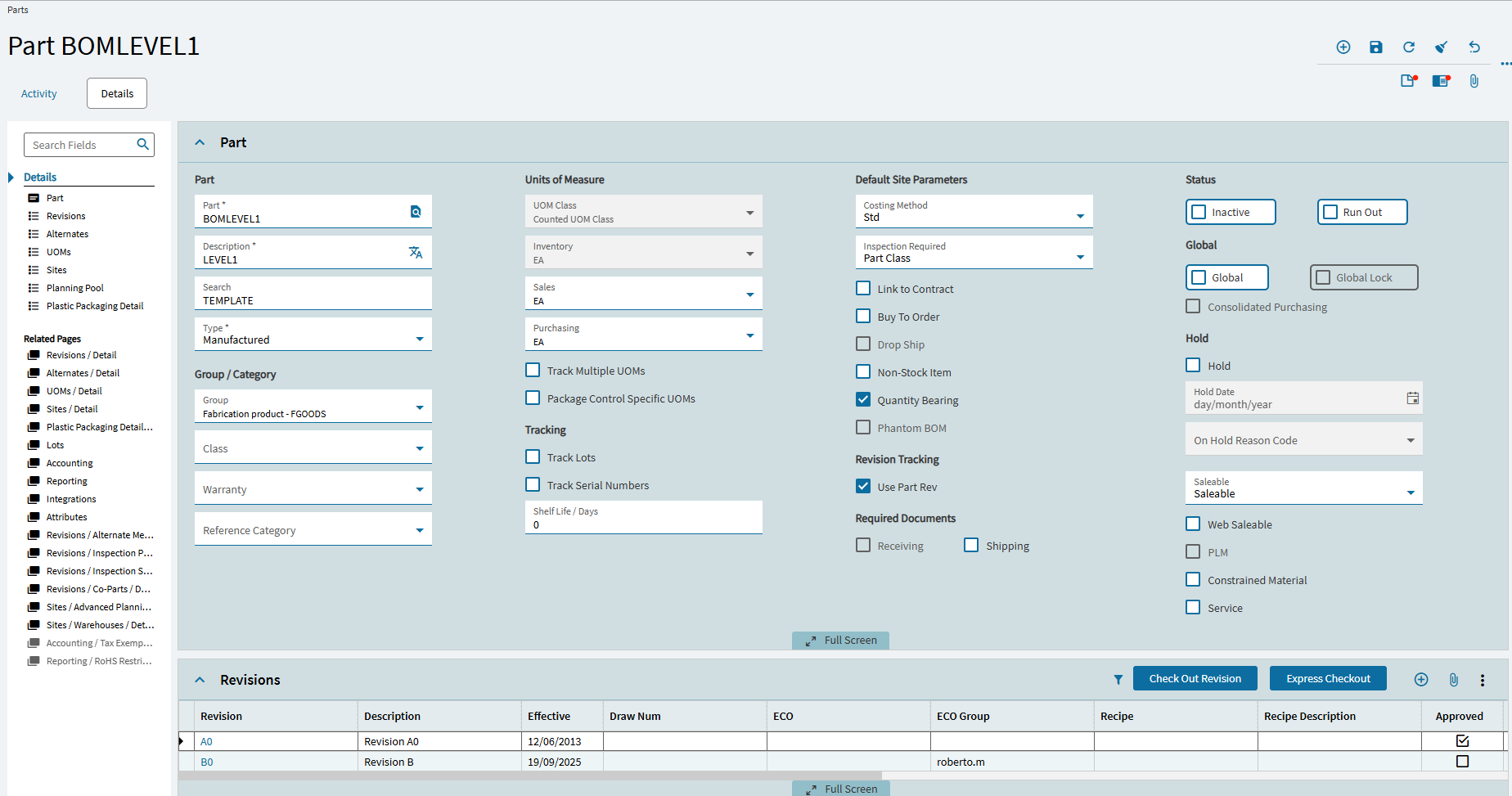

Screenshot from my client:
Track Inventory by Revision is not available.
My version is Kinetic 2024.2.9
Did you try the browser?
Is yours the base layer?
Do you have personalizations?
I believe that this requires a special license. Contact your CAM for more information.
If I remember correctly, this functionality was implemented in Kinetic only and was not backwards compatible to the client.
