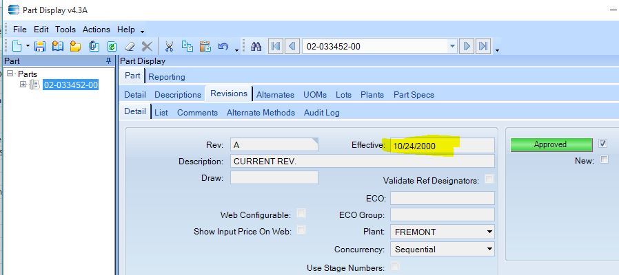

# Part Revision - Not found **Category:** [Epicor ERP 9](https://www.epiusers.help/c/e9/7) **Created:** 2017-01-10 15:22 UTC **Views:** 1295 **Replies:** 1 **URL:** https://www.epiusers.help/t/part-revision-not-found/36842 --- ## Post #1 by @cchang In the get Job Details for a subassembly job, we are getting the following error message: "Part Revision for subassembly was not found. Request cancelled. Looking for revision of Part: 225438 with an effective date less than or equal to 4/4/2017." Did a part revision get deleted or what could be causing this error message? --- ## Post #2 by @MiguelS Verify your Sub has an effective date less than or equal to today --- **Canonical:** https://www.epiusers.help/t/part-revision-not-found/36842 **Original content:** https://www.epiusers.help/t/part-revision-not-found/36842
