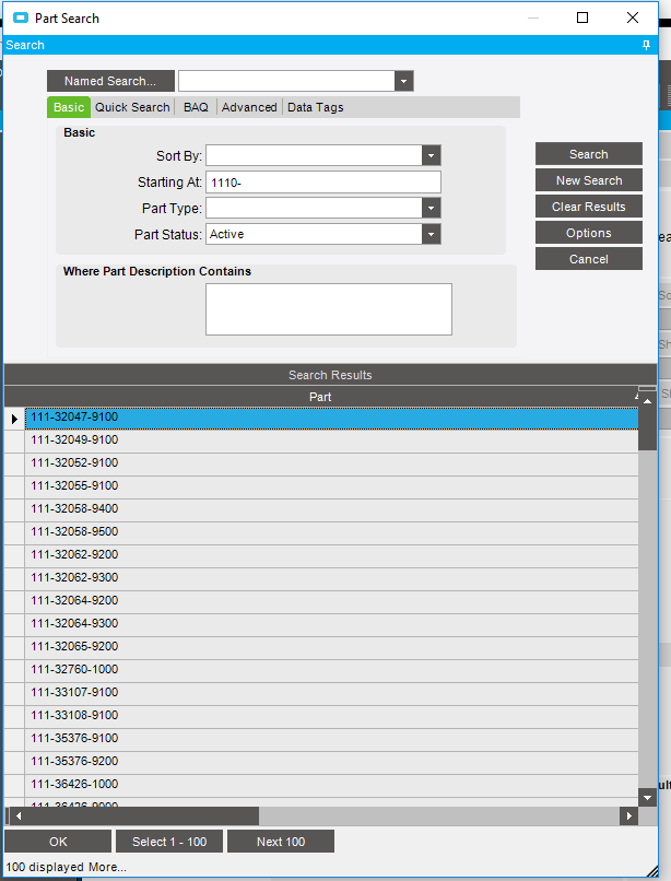

We have a bunch of parts that start with 111- and then another large set of parts that start with 1110-. When a user types in “starting at: 1110-”, the result set always returns those parts starting with 111-. Even if the user adds another number, say starting at “1110-5”, the results begin at 111-

Epicor does not seem to handle dashes well when doing searches as you see. It is probably some ASCII level thing?
For some companies with dashes in their parts, I have created a Starts With quick search for parts and made this the default. It seems to work better (still not perfect) than the out of the box search.

This was brought up a few weeks ago. The particular point in that thread was the sorting by part number, where dashes throw it off. I’ll try to find that thread
Edit: here it is
I see that I can remove the sort, but I can’t figure out how to save that on the part search form.
Nevermind… right-click, save layout
