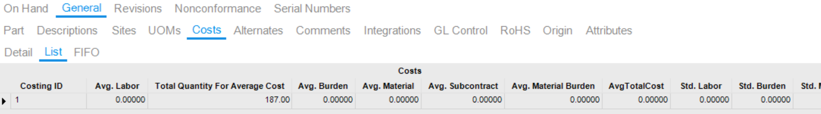

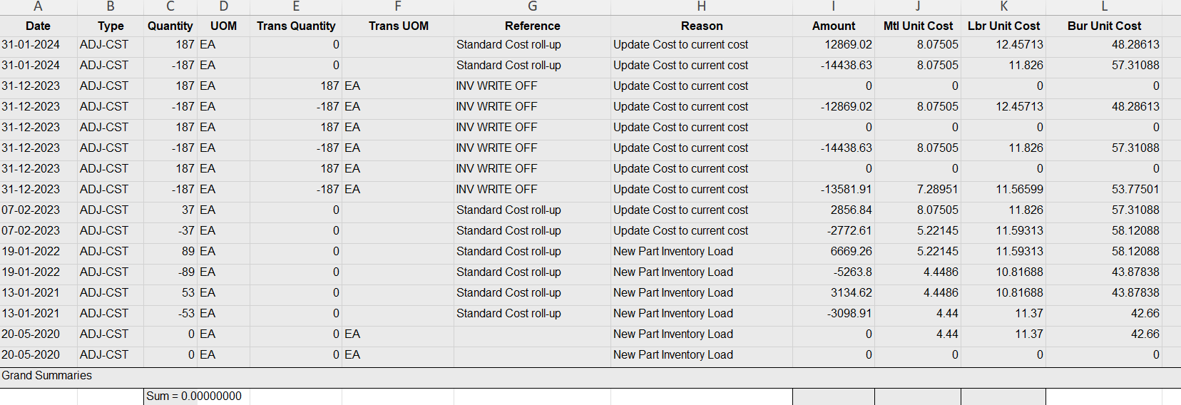

The Part Transaction History Tracker for this part SB100 indicates that on 1/31/2024 a cost roll was made which updated the part cost, but it seems the part cost never updated and remained at $0. PTHT shows the cost after the costrollup but when I checked in the part tracker shows 0 cost.

I filtered only ADJ-CST in the PTHT. Part tracker shows 0
In my experience, only entries in the PartTran file are those that affect inventory value. If there was no quantity on hand for a part when the cost update occurred, then zero times the old cost is zero and zero times the new cost is zero.
I’m with Mark. What does the Part Tran look like with all transaction types when you are seeing the zeros including the Running Total?

The cost in the Part Tracker also remains at 0. Why is that the case? For this part, the last cost roll was on January 31, 2024, but the cost did not update in the Part Tracker. What could be the reason for this?
Since the Part Transaction History Tracker has already recorded the cost roll, would the solution be to simply update the Part Tracker with the new cost amount? again this Qty is 0 on hand.

I don’t see any errors. I performed the cost rollup for this part in the pilot environment, and while I have the quantity on hand, the cost was not reflected in the part tracker. When I rolled up the cost again, it showed zero.

Senthil, would you please show us what cost site ID is applied to the site that you are in?
When you’re in the costing workbench it asks you to select a cost site ID to post to, is it the same cost site ID as the one you are looking at in your part tracker for your part?
Yes.
