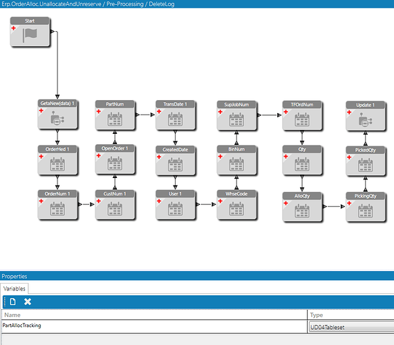

We are trying to see if it is some rouge bpm that mrp is kicking off that is deleting allocations or it is an employee. The warehouse will pick and pull 200 parts and sometimes the next morning the allocation will be deleted from fulfillment. We are trying to replicate what i built for sales orders, which is if a sales order is deleted it provides the sales order information and then adds the user and a DT stamp to UD04. We then can filter on different keys to setup a dashboard that allows the different department heads to view it. (we also have this for jobs). It was my understanding that we could not use a change long because like the bin tables once someone unallocated a part the record is deleted.

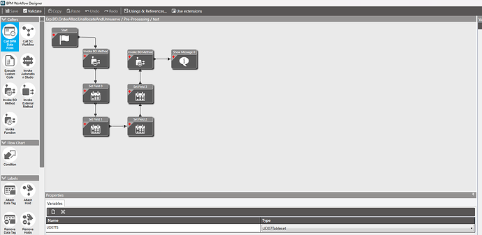

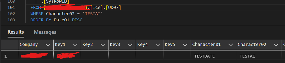

Please view the attached image. I used your method of setting fields, and this successfully created a record in my UD07 table.
Attached are all of the images of what you’ll need to put this together.
  1. Create a UD07 tableset variable
  2. Use the “ds” (dataset) which are the parameters passed to this method, to “set” those fields/data points you are interested in. Note: When setting the fields, make sure you are updating the UD07 tableset variable you created, not the OrderAlloc tableset.
  3. Once you set all your fields, call the update method, passing the previously created, and populated, tableset.

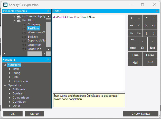

EDIT: Don’t use the “PartAlloc” DS to get the values such as the “PartNum”, use the OrderAlloc instead, to avoid that issue you are having.
Do:
Don’t:
