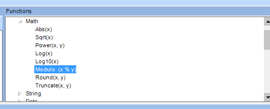

Use modulo

I’d go with your original suggestion: adding Partbin.OnHandQty mod 1 <> 0 to the where clause will list out any bins with decimal qtys.
I believe they accomplish the same thing. Which one is simpler is a matter of opinion I suppose. ![]()
FLOOR is supposed to ‘Return the largest integer value that is equal to or less than’ your number. FLOOR(2.99999999) = 2, etc
So where PartBin.OnhandQty <> FLOOR(PartBin.OnHandQty) should return the same results as Partbin.OnHandQty mod 1 <> 0
