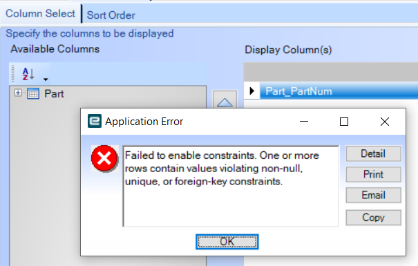

PartNum broken in BAQ?
When I have only the Part table in a BAQ, and the display field is PartNum i get this error and i cannot save or analyze.
2025-04-14 09_54_29-Business Activity Query Designer

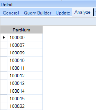

When i have only the Part table in a BAQ, and i make a calculated field for PartNum, not even casting it as a VARCHAR, just put the same field in a calculated field as is, i do not get this errror
2025-04-14 09_56_44-Business Activity Query Designer
I’ve had a support ticket open for weeks on this but no response, so i’m coming to you guys.
Additional context, old BAQs where Part.PartNum already exists in the BAQ work fine, no errors. If i add Part.PartNum to an existing BAQ, or create a new one as above, i get the error.
Only two suggestions I can think of…
Try adding the field Part.Company to your BAQ. I think those two fields would normally constitute the primary key, as the DMT template builder shows them as mandatory.
If running multicompany…maybe you don’t have permissions to all companies?
Escalate the case. No reason for something to sit for weeks without action.
I wonder if somehow you have ended up with a blank/null part number somehow.
Added Part.Company and did not work.
I am a security user, have all permissions etc. Also not my first time doing this type of thing so it’s very odd that this has come up.
We are multi-company, I’ve also tried adding criteria for each one, they all return this error.
SQL works fine, which is where I do most of my work, so i’m unsure exactly when this might have started. Had to build a BAQ in Epicor which is when i found this error. Again, old BAQs work just fine so this is very very strange.
I actually did escalate my ticket earlier this morning so thanks for that, we’ll see where that goes. Any other troubleshooting methods i could do?
I’ve tried looking for PartNums that have strange characters, begin with spaces etc but nothing comes up, i used LEN(Part.PartNum) and went through all the ones that didn’t line up with our 6 digit standard. Nothing new has been created.
Sorry…wish I had better ideas. Seems odd that old BAQs work but you can’t construct new ones without that error.
Only other odds and ends I can think of - clear out the sort order in the BAQ if there is one, maybe run some health queries via SQL to check constraints etc.
Otherwise I’d wait for Epicor support.

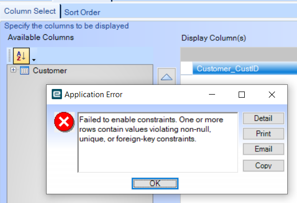

Good grief, same error when using Customer.CustID
2025-04-14 13_02_24-Business Activity Query Designer
Here’s hoping escalating helps…
Yikes…sorry it’s gone from bad to worse. Two master tables throwing the error seems to point to a larger problem. If you can get to the data in SQL without them popping up…that’s good…at least the data tables are hopefully intact. Good luck.

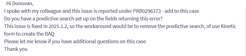

Escalated this in EpiCare and still haven’t received a response.

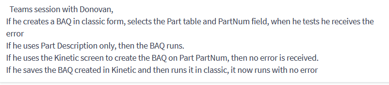

Had a meeting with EpiCare
Solution. Predictive Search is creating this error.
Kinetic BAQ works just fine
