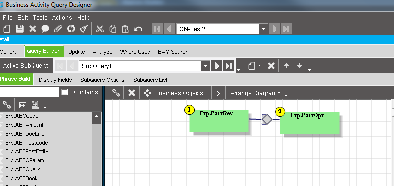

I’m trying to build a BAQ that shows PartRevs that have a method but no Operations that are not phantom. I was going to left join PartRev on PartOpr and return any PartRevs that are not in the PartOpr Table. I cant get it to work with a sub-query.
Any thoughts?
Try creating a sub query using the ‘Except’ function

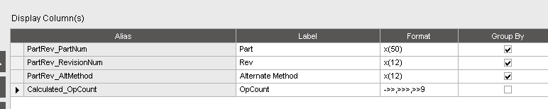

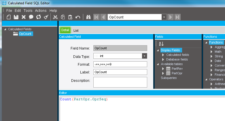

You could also make a subquery with PartRev left joined to PartOpr. GroupBy PartNum and Rev and Count the number of operations per PartRev. Then in the top level, filter out all the Parts with non-null number of operations.

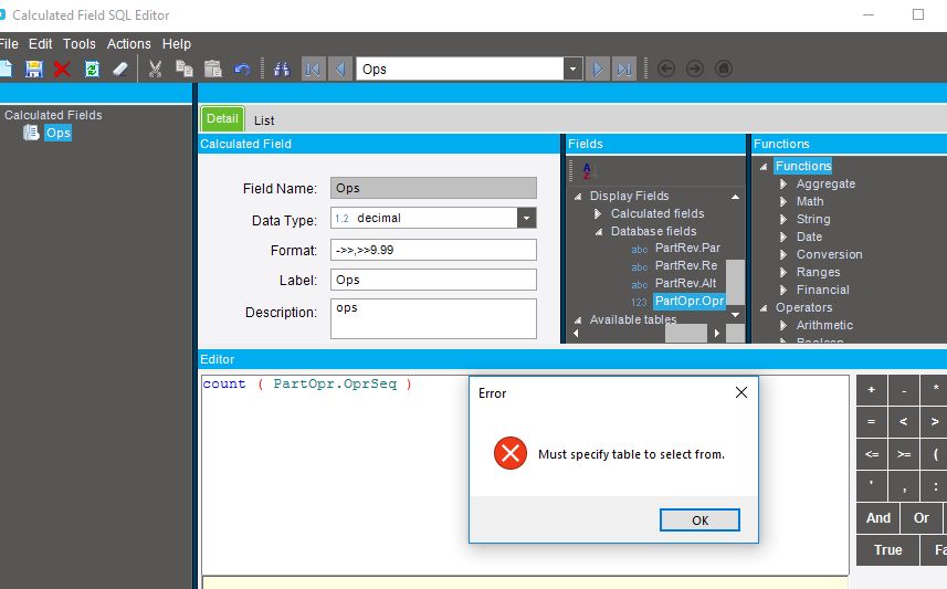

what am i doing wrong on this calculated field?
You can’t have the field in your displayed fields, and use that field in an aggregate. (I’m assuming that’s that you have going on since the field is showing up in your database fields section).
Not sure, but I got it to work like this:
Thank you. that worked.
