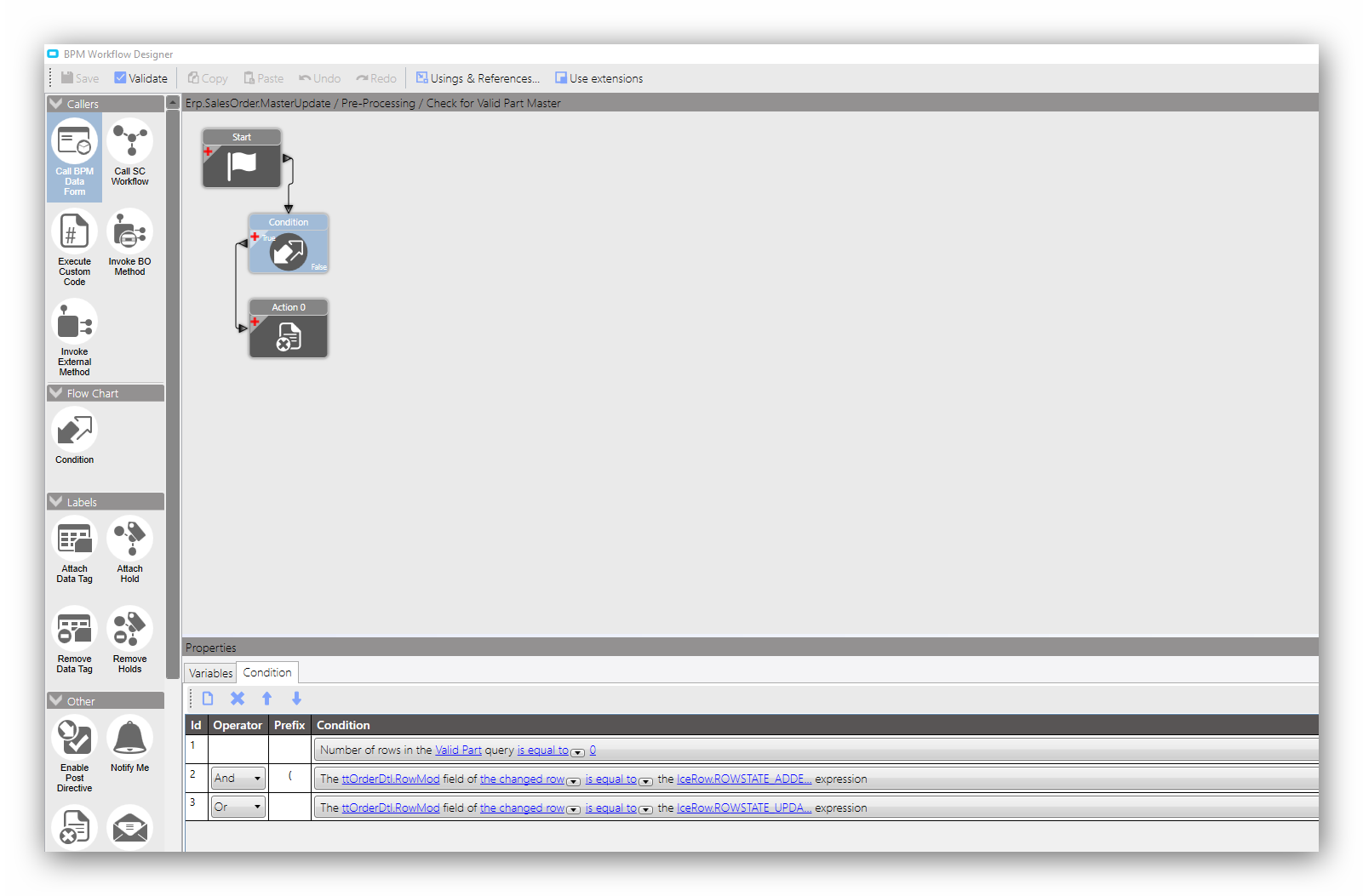

We have a BPM on SalesOrder.MasterUpdate that throws an exception if a Part Number is entered on an Order Line that doesn’t exist in the Part table. I imagine it would be a similar BPM on the Quote BO.
@tsmith - you should probably add a table criteria to to the query, with
Part.Inactive = FALSE
Good catch, thanks. There are probably a few other similar BPMs in our system that need that filter added.
And make sure no one slipped in a part MISC, that they can just change the Desc to whatever they want.
also define the Company and PartNum as variables and add them as filter in the ERP.Part instead of linking to the ttTable (it is not recommended)
Thanks Guys. This works great.
