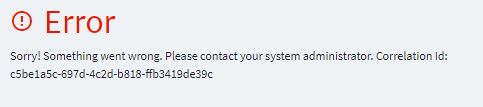

  • But the two of these combined results in the helpful “Something went wrong” error.
I don’t see any other chatter on this. Maybe it’s just my version that’s acting up?
Here, this should shed some light:
I wish I could help… but I just have to laugh about the ever so helpful error.

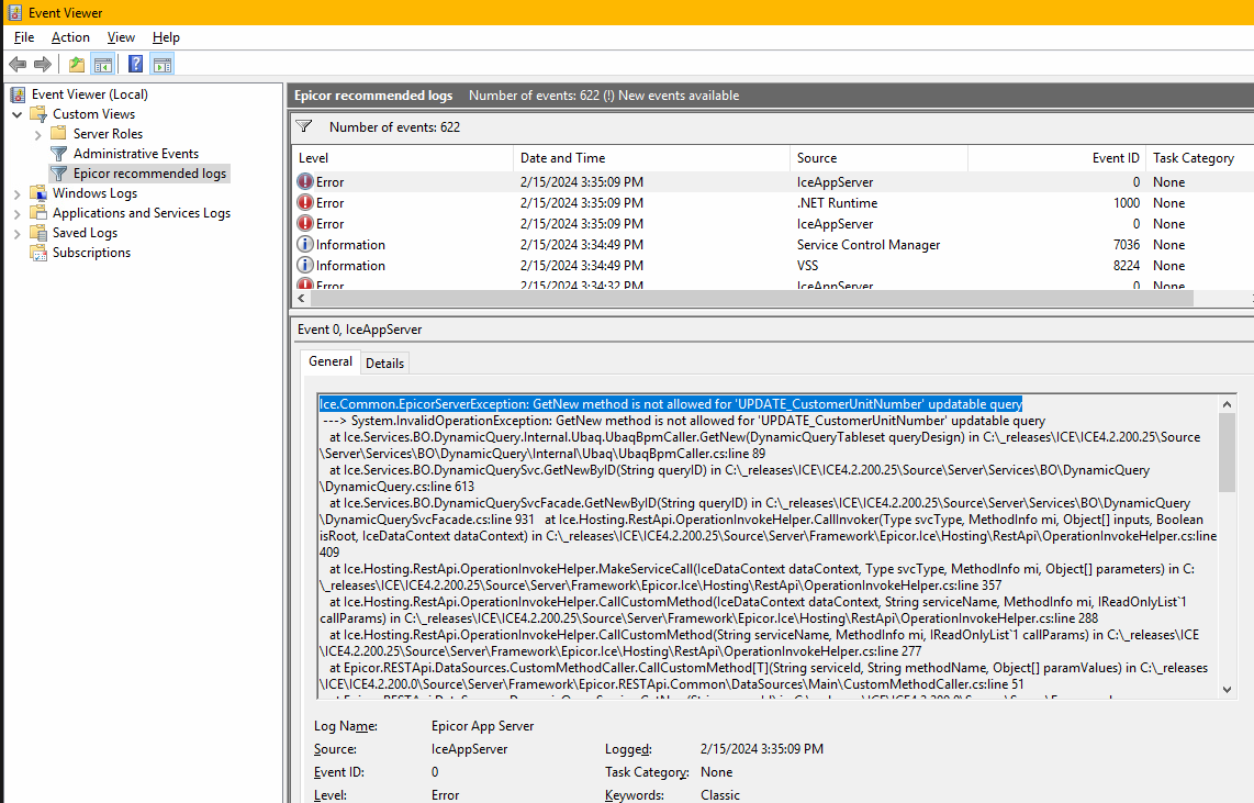

Both event viewer and app server log

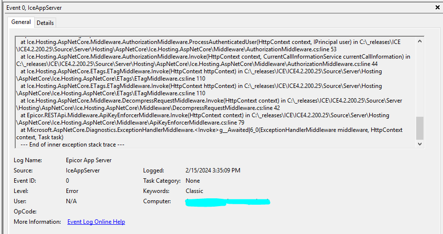

For the event viewer you go to the server, open event viewer and in the Epicor App Server branch there will be the messages, one of them will contain the correlation id.

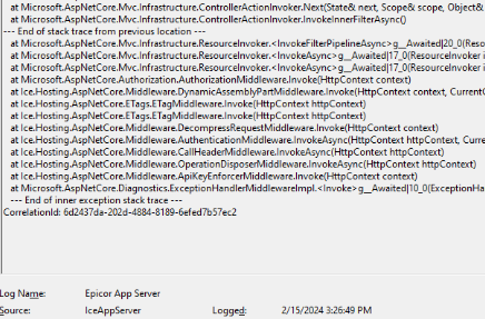

So, this is where I look:
Indeed, this is the uBAQ that I was trying to paste-update. So, two questions:
  • On topic: where is the correlation ID in that?
  • On the original topic: why is it trying to “GetNew” on a Paste Update?
[edit] The correlation ID for that moment is 10fcb3f0-9555-4391-8fd8-373e834f38d5 (I replicated the error after the OP)
Scroll to the bottom of the message
I’m missing something.
I copied the whole thing to notepad and then did a Ctrl+F and still see nothing matching.
Then maybe in your version correlation id was only in the server log.
I think it was added later at some point.
Now it looks like this:

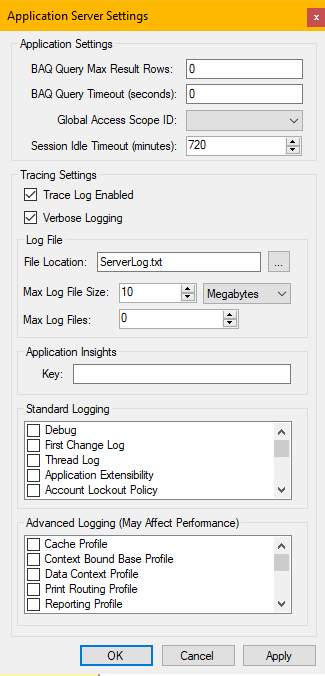

Do you know what server log is and how it is switched on in Admin Console? Then you can go to the file named usually ServerLog.txt and search for correlation id there.
I’ve never found it either @JasonMcD and I’m also on prem. Wish I could though.
After some stabbing in the dark, it would seem that no, no I do not.
That will be wonderful when I am on that version. (No sarcasm; I know it sounds like it is. But that will be very helpful.)
@Olga Oh never mind, I had to go back to the first place I looked lol.
I just now checked the box; it’s not normally logging.
Is there perchance a guide to what all those options are?

Leave all values empth then. exception will be written anyway.
I am just not sure if defalt folder is okay, it will create file right in the server folder, maybe some other disk with a lot of space is more reasonable.

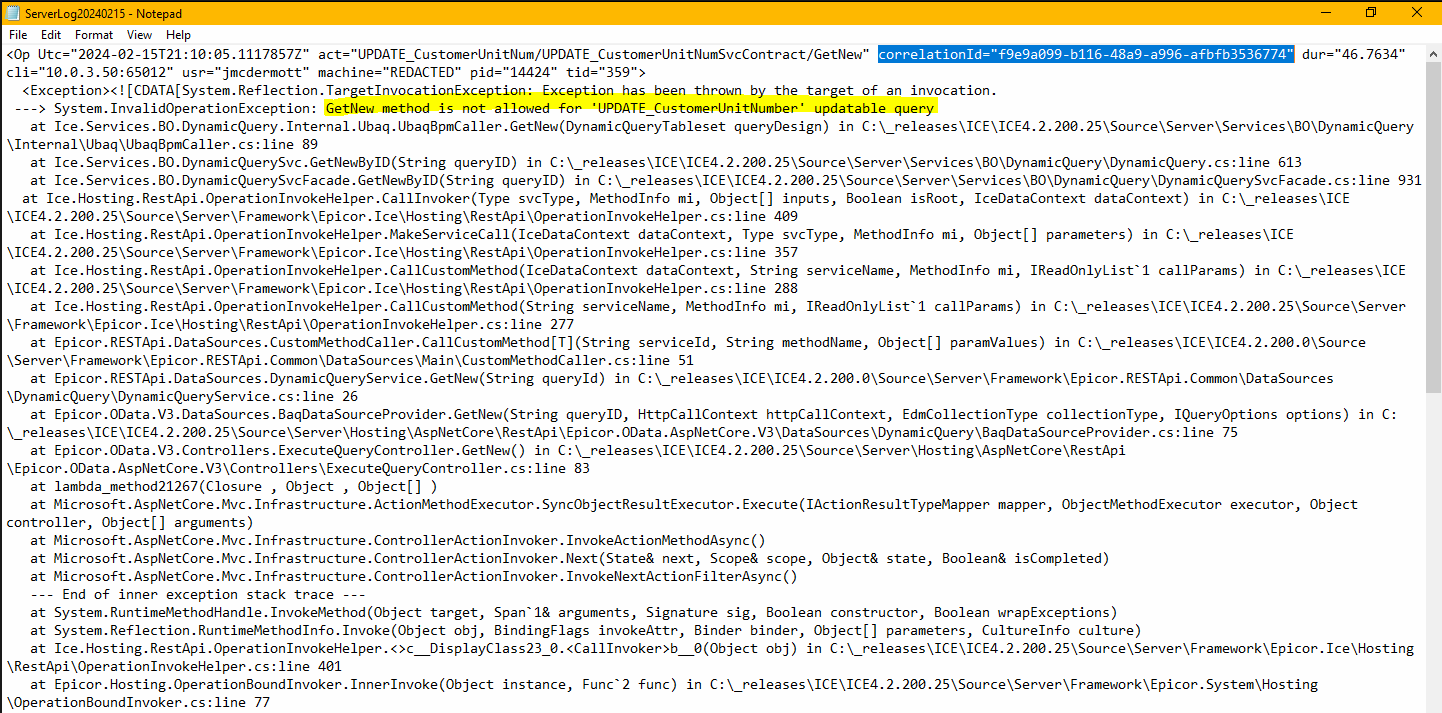

That worked as advertised - thank you @Olga !
There’s the correlation ID and the error message for it.
@utaylor @dcamlin If you are interested.

I see that now, it put it in C:\inetpub\wwwroot\Development\Server
Specifying the location is better advice.
