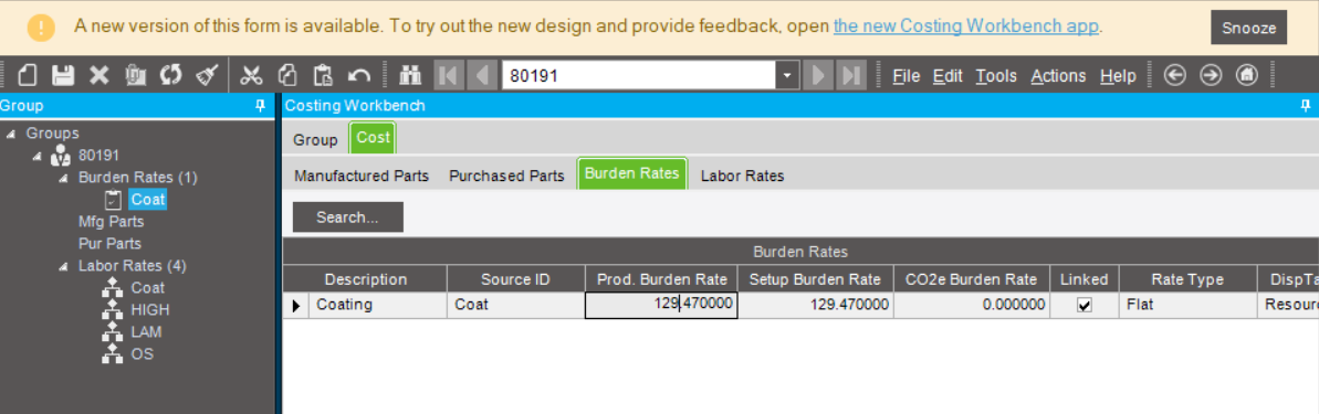

Hello, I hope everyone is having a fantabulous day ! I am attempting to update our burden rates and I am very new Epicor. No techs here to consult with everyone in this company has to learn for themselves. So I got to knowledgebase to update burden rates and I get hung up in ‘pasting’ update spreadsheet back in. the selection to paste update is greyed out. can anyone advise what I am missing. I am almost there. Thanks!!

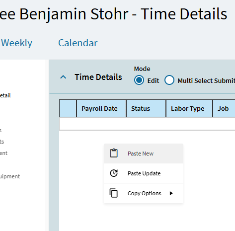

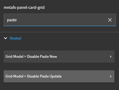

Paste update/new is an option in kinetic. The grid you are trying to update might have it disabled. You might have to go into application studio an enable it.

ok I believe i am in the classic version.
I am going to shut down and try again
Yeah, that’s classic.
Ok, it’s there in 24.2. But is disabled on every screen I’ve checked. Works to enable. Thanks!
I have Paste New

I just needed to enable it in the layer. Not sure why it’s off for some and not others.
