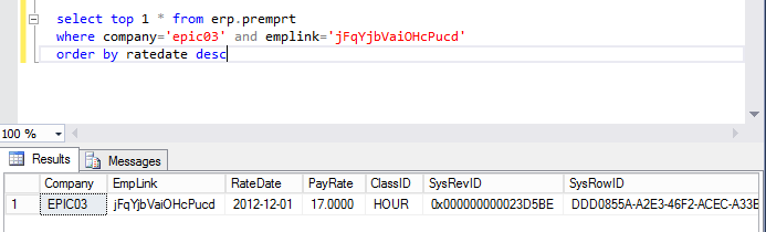

in the BAQ, if you select the top 1 row of the table for an employee, and then order by the ratedate desc you should get the latest payrate.
How I did it in SSMS (not sure this is the correct table, but the process would be the same.) Top 1 row, order by the date field desc.
I’m not quite sure how to do that in a BAQ. I’ve not seen a screen like that before. I currently have the PREmpmas and Premprt tables linked by the company and emplink fields.
I’m using the BAQ Designer app to build the BAQ.
