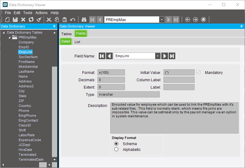

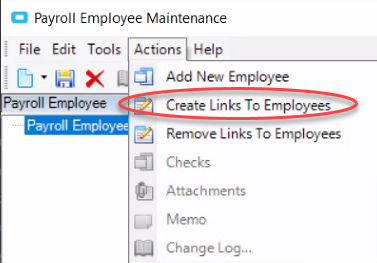

I have a BAQ that is joining the PREmpMas table to the PREmpRt table to view historical payroll rates. When I first created the BAQ several of the employees had no value in the EmpLink field. I corrected that by running Create Links to Employees.
That populated the field and the BAQ worked fine. In the few weeks since I created it several EmpLink fields have gone blank. Does anyone know what triggers the EmpLink field to go blank and is there any way to keep it from resetting?
I’m interested in a permanent solution. I just have to remember to break and create links anytime I do any employee reports.
Which is probably why the menu options exist unfortunately.

As to why Epicor made it manual process…they don’t actually expect you to have permanent EmpLinks. They expect you to generate links only for occasional ad-hoc reports. It’s a privacy feature.

Hey, I made this change, the idea is that employee links should not remain on the database permanently for security reasons, back in E9 that is how it worked but somewhere in E10 the links that were calculated to retrieve rates and other info remained after save, which was not correct.
Base reports will generate the link on the fly, but it is indeed needed before something like a baq query or report.
