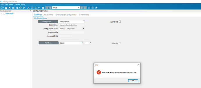

I’m not quite sure if I am missing a step or what, but I cannot seem to add rules to my configurator.
This is the error I get

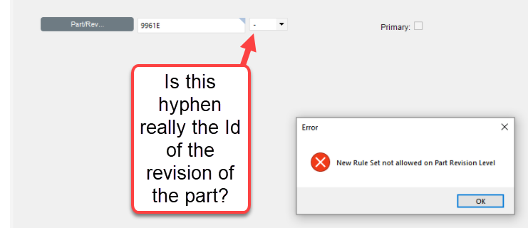

yes, our old ERP system did not keep track of revisions, and our engineers did not keep a repository of what revision parts were on, so the default revision level for our parts during conversion is “-”
Do you have a bom and a boo setup in this revision? If so, I would try to call it an alphanumeric rev ID and see if it works. If no bom or boo, I’d put those in and then try to make rule set.

I had a misunderstanding on how the rule sets work. I had not selected a BOM item to apply the ruleset to , and that was causing my error.
