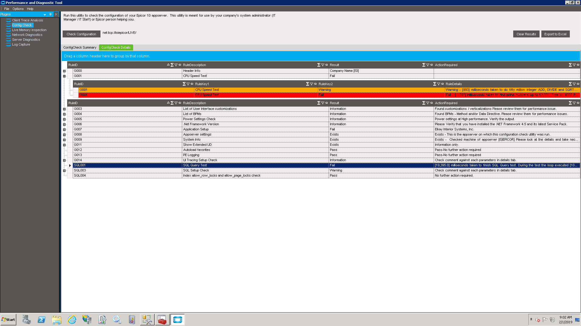

So, on Wednesday, my users started receiving the below error. We ended up having to reboot the (virtual) server to clear it up. Ever since the reboot, Epicor has been running extremely slow. I ran the PDT and received the terrible results below, but I’m not sure what to do with that information. Before the error on Wednesday, the PDT was passing everything and our SQL results was around 2,700-3,000ms. Where do I go from here?

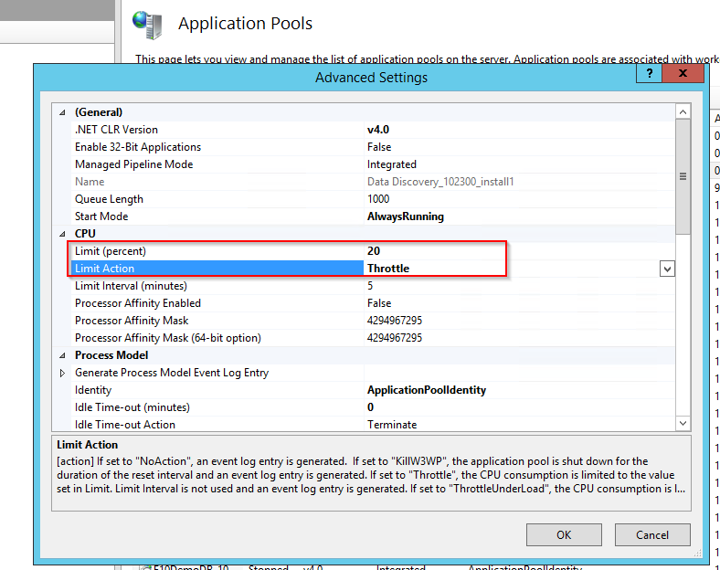

Have you looked at the BIOS c-states on the physical host (made sure the host is set to high-performance mode in the BIOS)? Are other VMs on the same host running slowly? Recent Windows updates that were applied during the latest restart? I’ve caused the same behavior to happen on purpose by throttling the CPU on the application pool, but, most people wouldn’t do that.

@aidacra - C-States should be disabled. I was plagued by that back in 2016. The host was not rebooted, so I don’t think those would have changed. Other VMs seem okay. Actually, the VM, itself, seems fine. SQL isn’t moving too fast, though. No Windows updates were applied and the app pool is set to zero and ‘NoAction’.

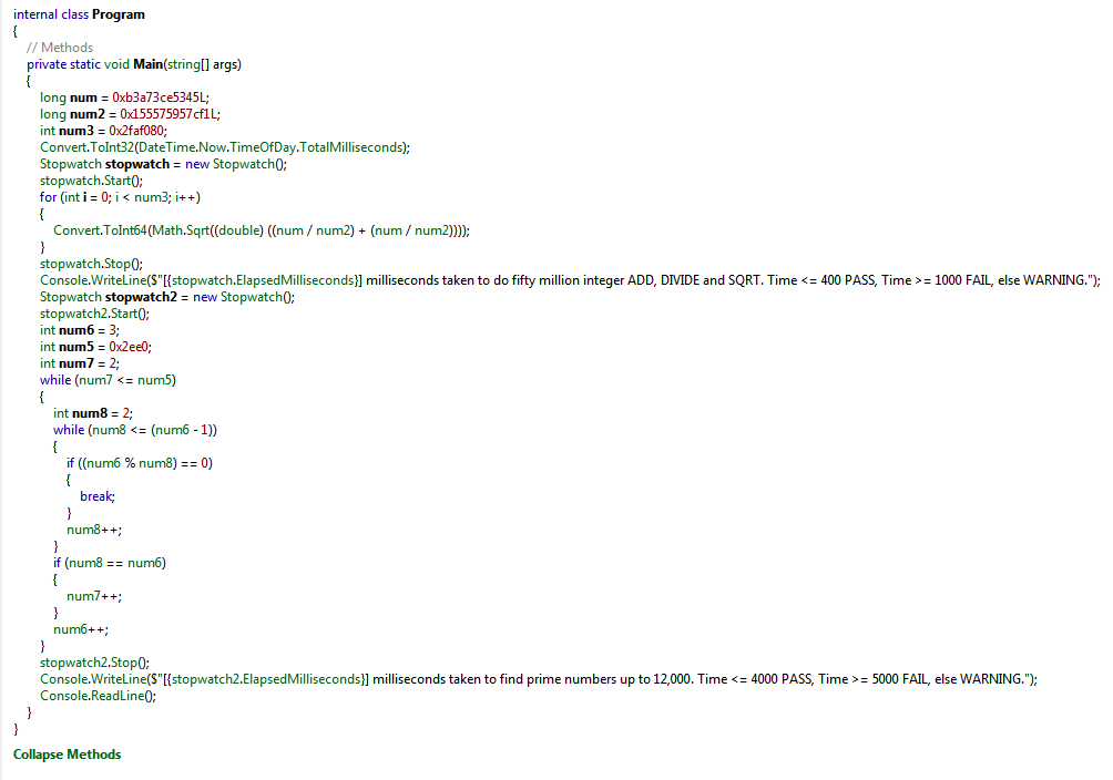

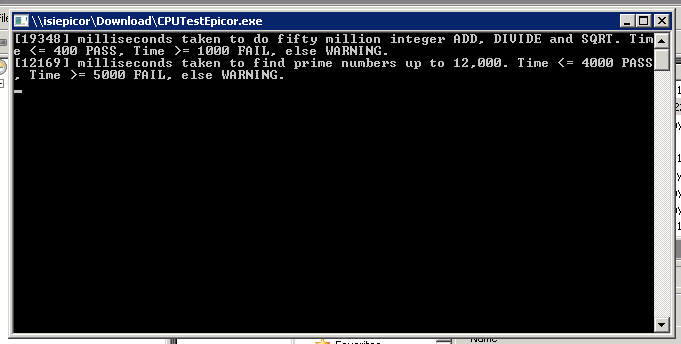

Did one of your CPUs go bad :slight_smile: - All Epicor’s test does it runs a while loop and does math and calculates with StopWatch. Hope you figure it out. Only time I had bad CPU test results via PDT is after updating VMWare to HW11 and aftering installing a mismatched Firmware on Cisco Blade.

Take SQL out of the mix, that CPU test is really just the App Server you are running the Test. and not even the IIS but literally just the Operating System of Whichever instance you are connected to via PDT.
So now let’s put Epicor aside and focus on the CPU - its probably related to Windows, Hardware - take out the App Pool because that test is really just foreaching division statements, nothing more nothing less.
Now if you trust me download this and simply RDP into a few servers, paste it and run it:
It is not a virus, garuanteed =) I had to strip the CPU Test from Epicor and run it on servers to figure out my bottlenecks months ago. Does the exact same logic as PDT (took it out of the BO that executes that CPU test)

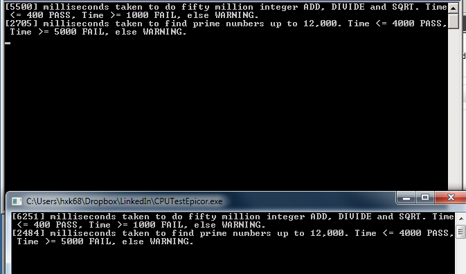

2019-02-01_1131
If I recall its the bottom number that is the CPU Result.
Here is a .rar version incase you cant dl .exe
Take this and run it on other non-related Epicor Servers, prob even your HyperV or VM Host if you can. Your SQL your SSRS your RPT Server if you have a diff, prob other APP servers. Easier.
Epicor App Server

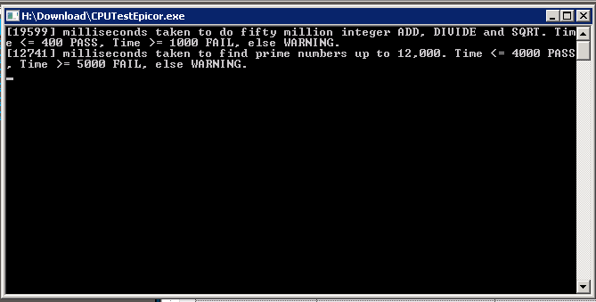

Same Host, Different Server

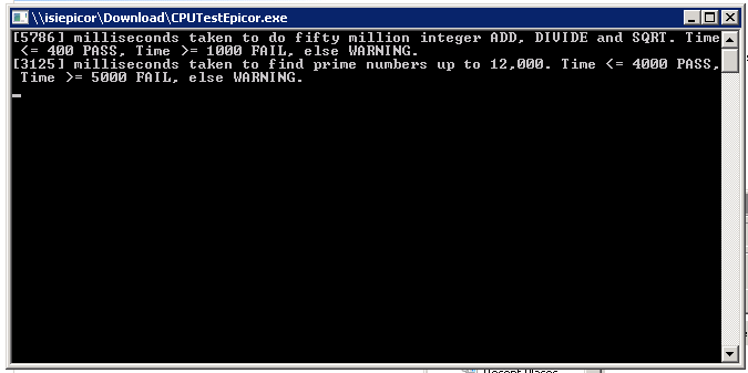

Different Host
Awesome so something is going on with your Host. Atleast we can narrow that down :slight_smile: If you go to any OS hosted on that Host and you get the same results, now you know to look at the Host.
