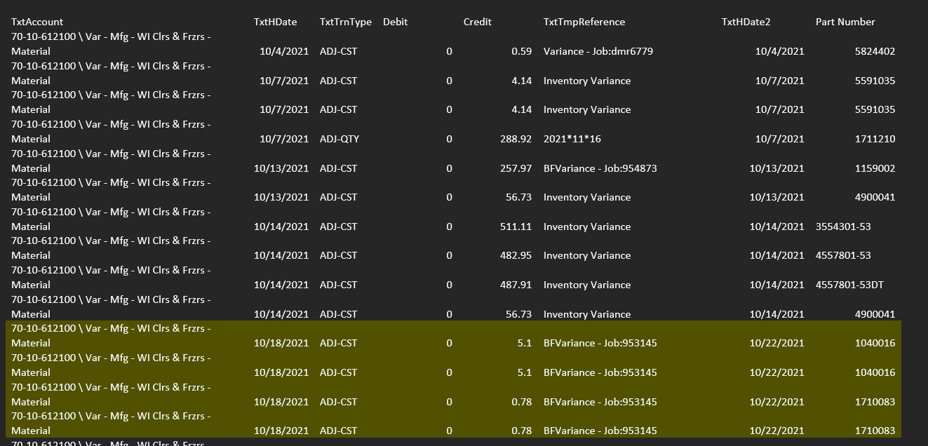

My finance team found some Periodic Posting Process credits/debits that are hitting a division that is mostly defunct now, and they very much did not expect coming from Jobs in a completely different division / state. When looking at the details in the posting (Inventory WIP reconciliation report, I assume?) they are seeing the below transactions, and asking me how to figure out who/what did this? Related question (maybe): what does “BFVariance” stand for? Best Friend Variance? :stuck_out_tongue_winking_eye:

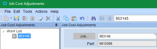

I tried opening up the job in question in Job Adjustments, thinking maybe someone did something in there (we normally don’t touch that as nobody fully understands it at this point), but it didn’t see any records in there for this job (maybe I’m expecting something that will never be there?).

@Noffie look in PTHT for records related to that job. I would assume BF is backflush and someone/something changed a quantity somewhere and the previously backflushed value had to change, but the job is completed/closed so the delta had to go to a variance account. The posting rule that did this is either custom or has a flaw that crosses divisions improperly.

The Job Cost Adjustments screen will only show adjustments entered in the current session (in the tree at the left), it won’t bring up past adjustment transactions after the window is closed.
