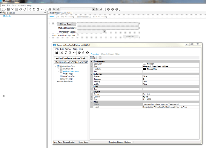

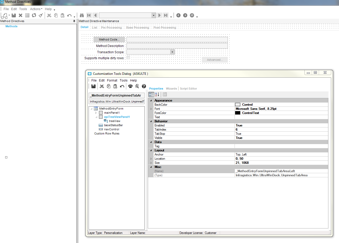

I opened Method Directives, pinned left column open, opened field help, opened tech details, resized the left column (not a list view column), and then selected Options>Save Layouts. The field help column still autohides.

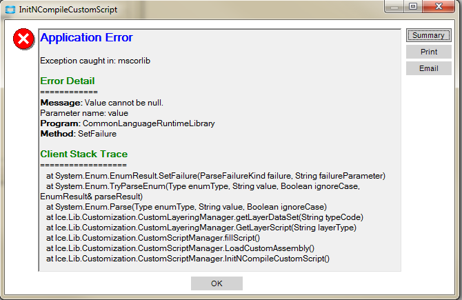

I closed Method Directives, turned on developer mode, and opened it up, then selected my personalization, but nothing was pinned open. I then went to Tools>Customization, got an error (I’m guessing related to not having any customizations for Method Directives, so I saved one), and see epiTreeViewPanel1.
When I resize the horizontal bar so Field Help has more room, the vertical size adjusts in the customization window, but it defaults to full 100% when I re-open it. It also doesn’t seem to attach field help and tech details, which requires opening it every time.

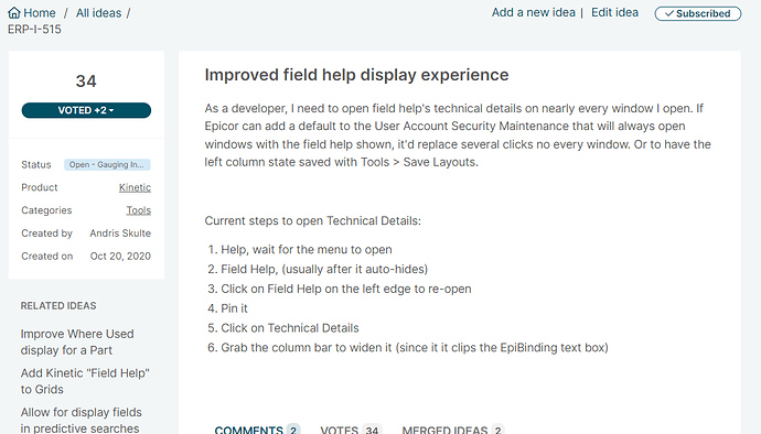

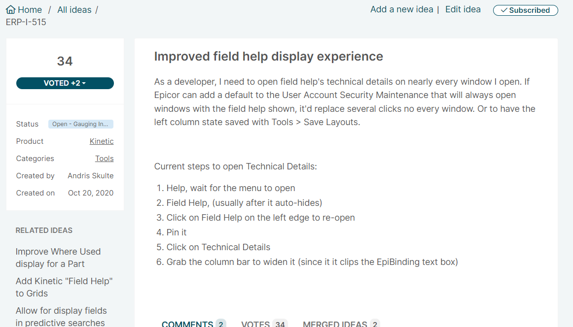

As a developer, I need to open field help’s technical details on nearly every window I open. If Epicor can add a default to the User Account Security Maintenance that will always open windows with the field help shown, it’d replace several clicks no every window. Or to have the left column state saved with Tools > Save Layouts.
Current steps to open Technical Details:
Help, wait for the menu to open
Field Help, (usually after it auto-hides)
Click on Field Help on the left edge to re-open
Pin it
Click on Technical Details
Grab the column bar to widen it (since it it clips the EpiBinding text box)
