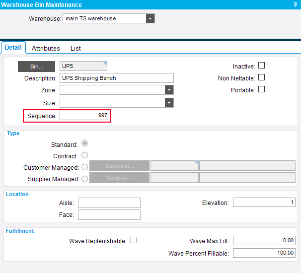

Since the MtlSeq numbers in our BOMs don’t represent anything in particular, and especially not the order we want stuff picked from the shelves for jobs, we use the primary bin’s BinSeq and the bin number itself to sort our pick lists. Bin numbers are mostly like A-01-01 for us (section, shelf, bin), but the sections aren’t ordered A-Z in an optimal picking order, so we’ve got something like:
0 - G-12 thru G-17, H-12 thru H-17, MM-E, MM-F, MM-O, W-04, W-05
1 - A, B, Y, Z
2 - C, D, E, H-01, H-03, X
3 - F, G-02, J, V
4 - more A, more B, C-05, the rest of G and H
5 - I, J
6 - N, Q
7 - R, S
8 - U
9 - packaging areas POU and table racks
10 - ???
11 - closets and offices
etc…
300 - a few F bins at the end, maybe backflushed parts, idk
997, 998, 999 - shouldn’t normally be picked from, always sort to the end
…with a bunch of bins that don’t fit the naming scheme thrown into various places in the sequence.

I feel stupid… where is this field (assume it’s a field)? WhseBin table?
If I had some sort of bogus sort to do on bins, I have used Aisle in the past.
Yeah, WhseBin.BinSeq
