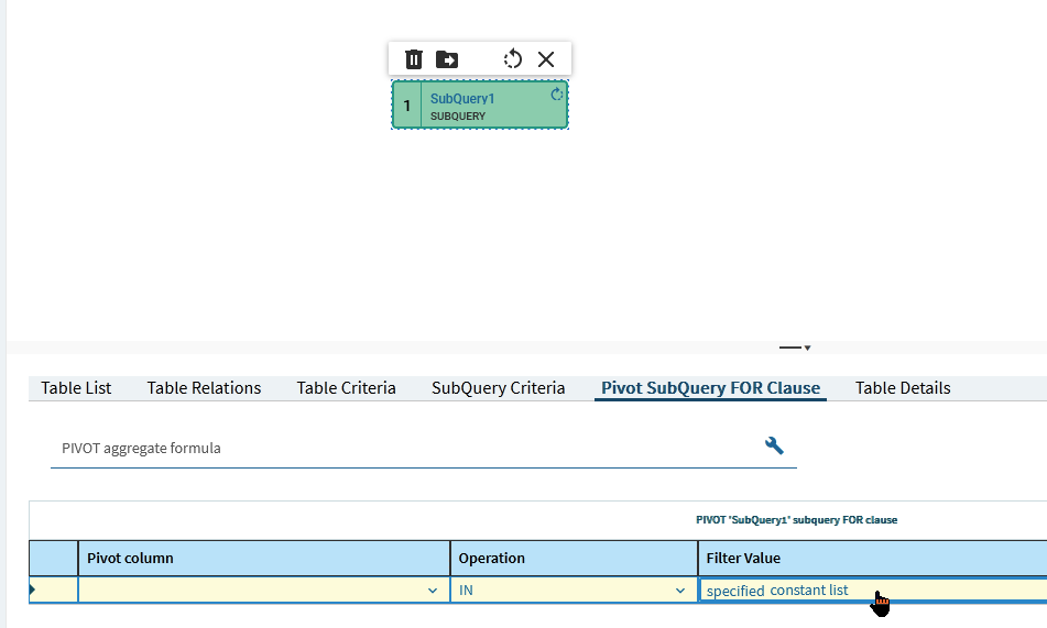

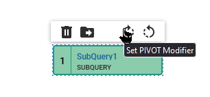

I don’t believe you were ever able to pivot with dynamic values. This is how you set the pivot, and you do the same basic thing you did in classic.
